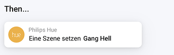

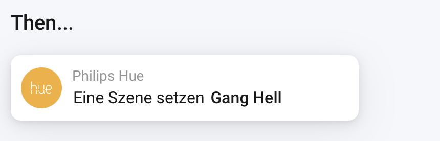

Just rename the scenes at the Hue App to which room the scene belongs.
In the flow i use the following card:
And like all solutions, when presented with it, it’s simple. I did not know about this. Cannot rename existing ones though, I’m sure they are easy to recreate in Hue app. Thanks
Right, thanks to @Tequila329 for kindly pointing me in a much better direction that has removed much frustration, I have done exactly as he said and have removed a couple flows and approximately 12 cards from another across 4 flows… And it all works better. I do feel a bit stupid that I hadn’t realised that that could be done. Everyday a school day
