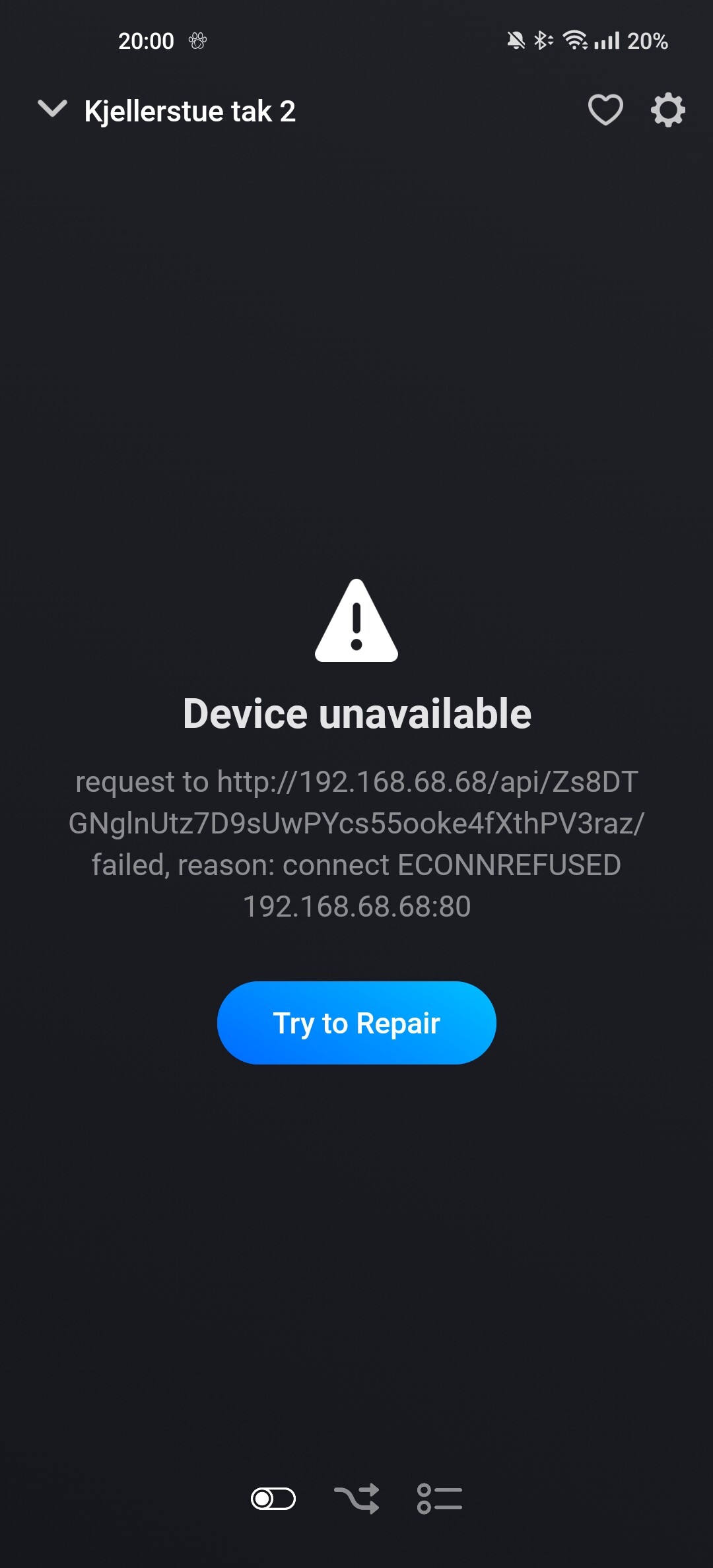

Hello! I’m currently subscribed to Homey, and I’ve noticed that when I make changes (such as turning lights on/off or adjusting colors) to my Philips Hue lights using the Philips Hue app, the status of the lights doesn’t update. However, if I make the same changes through the Homey app, the status updates as expected. I’m wondering if this behavior is a bug, intended functionality, or if I might have overlooked something. Could you please provide some clarification?
Status updates for Hue can take up to one hour, that’s how often Homey is allowed to poll the Hue API.

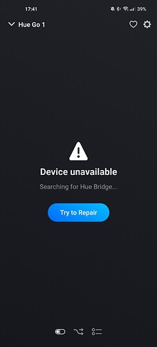

I had a power outage yesterday and suddenly most of my lights stopped working in Homey. ( 2/3 bridges don’t work with Homey. And most of the lights in the 3 bridge doesn’t work (see attached image) I
All the lights still work in the Hue app.
I have tried to restart the bridges, restart the app in Homey. I have also checked my mesh network and everything seems fine. Anyone have an idea what might be the problem? The weird thing is half of the lights in the 3 bridge work, but not the other half
The problem might have started before the power outage. I have motion sensors all over and don’t use switches so wouldn’t have seen the problem anyways
V
It’s possible the Hue bridge(s) got an other IP address, if you haven’t reserved it at your DHCP server.
Try to PtP (unplug for 10 minutes) Homey, maybe it’s forced to find the Hue box(es) that way.
I forgot to mention the bridge in the first floor was connected for a little while this morning also.
I added a Somfy garage opener to Homey and used a contact switch from my 1 bridge to open the garage.
But suddenly that card was not a option.
So it seems the problem comes and goes. mostly goes.
Should I still try to restart?
Now alot or the lights that had an error, also got faded out, along with the error.
Yes restart by cutting Homey’s power for 10mins can’t hurt and might help.
Also, are you sure there’s no issues with your wifi / LAN networks?
The Net Scan app can monitor and log Homey’s connection to the Hue boxes and your router.
I tried the restart for 10 min and nothing changed.
All my lights and accessories on Bridge 1/2 don’t work
All my lights on Bridge 3 work, all the hue accessories don’t.
Everything else in Homey works. I have done a diagnostic on my Deco’s and everything seems up to date still. I also did a restart on the Network.
The faded out hue lights had this error now after they tried to connect for a while
Also when I try to delete a light and add it from scratch I get the option to add all my lights that I originally had in Homey, as if all of them are deleted. Same goes with motion sensors.
Edit: I run the test version for so I can use the contact sensors on Homey
What happens when you try Repair in Homey?
This requires access to Hue hub as you have to push the big button on the Hue Hub
I figured it out. I installed the test version of the Hue app to get my contacts sensors added to Homey. I had on “automatic update” of the Hue app. And ofc after the update I was no longer on the test version. I installed the test version again and everything worked fine.
Thanks for your help :bouvet_island:
