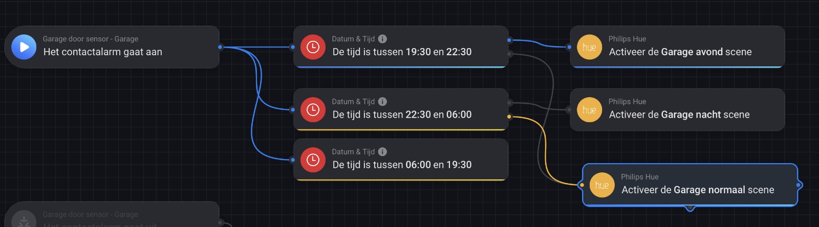

No, the bulbs did not have the warm color used beforehand. There just isn’t any explanation why it is happening sadly.
EDIT:
I have fixed it.
I should have used the test function in Homey. Now I have seen the line it is super logical it failed, both of the conditions were true. Thanks anyway!

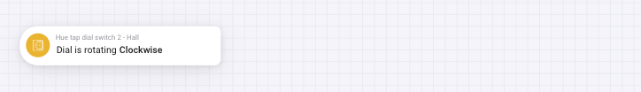

I have a Philips Hue tap dial switch. It has a ring to dimmer the light on the switch. How can i build a flow to dimmer the lights?
Haven’t really had much chance to figure this out, suffice to say it is not as easy as the dial function is in the Hue app. What I have got so far is…
It kinda works but not as well as I want
