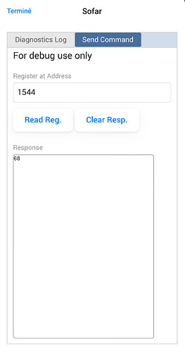

How do I manually try registers? Just typing random numbers in the ‘send command’ box? In that case, I merely get:
I will check as it’s been a while, but it should send a request to read the register and show the result. I can’t remember what it shows if nothing is returned, but I don’t think it is what you see, although it does show that an inverter has been detected.

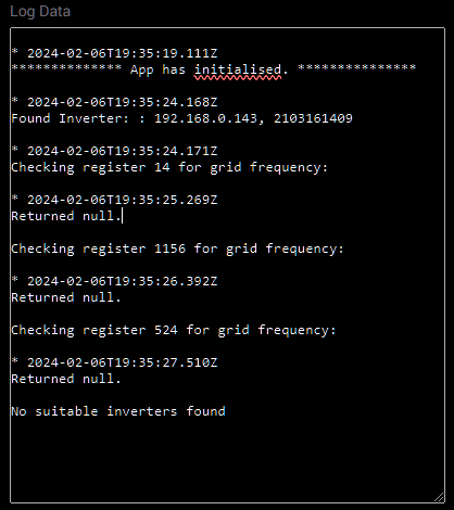

Checked the code of a project to connect the inverter through MQTT (my back-up option, but a lot more complicated it seems to me, https://www.instructables.com/Sofar2mqtt-Remote-Control-for-Sofar-Solar-Inverter/)
In the code, it mentions the following, but it seems to point to 524 (0x020c) being the gridfrequency register, which didn’t return anything:
If that app works for you then I can probably use the information to create a map to see if it works. It will be in the new Sofar app though.

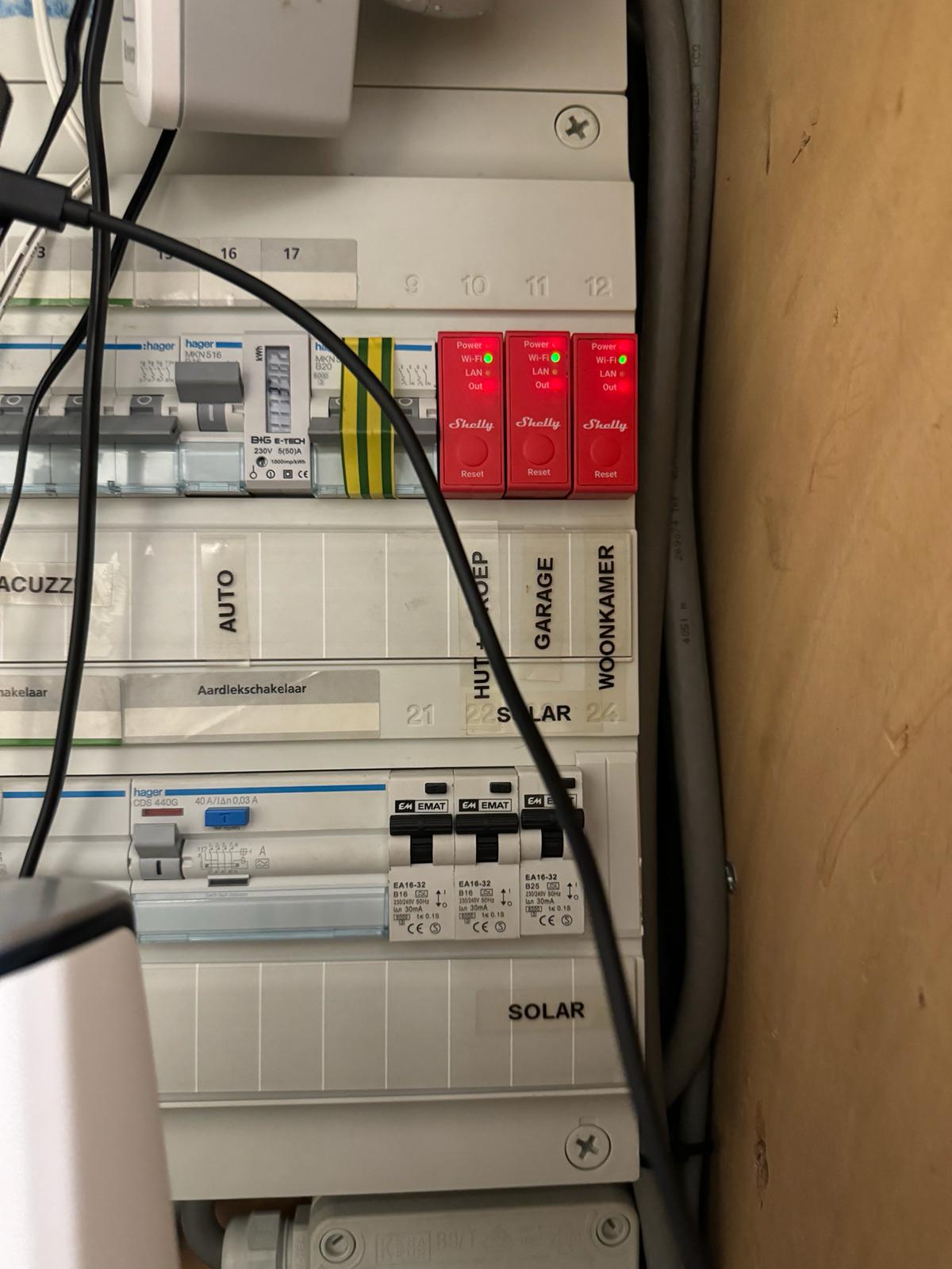

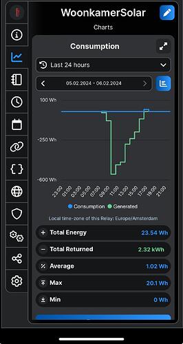

The Solarman Alternative Solution :
After numerous solar apps API’s different brands I installed yesterday 3 Shelly Pro 1PM smart relais including energy measurement.
Cons :
  • not cheap
  • not easy to install as you need some knowledge of electricity
Pro’s :
  • No more SolarEdge or SolarMan App’s
  • Accurate measurement Solarman App is not giving correct data
  • Can remotely switch off your Solar Panels for example when you have to PAY for delivering Electricity
  • Nice daily reports are easily to create
  • No more frustration in installing and reconfiguring bearer tokens when expired
  • Solar brand independant
  • Not being monitored by the Chinese :wink:

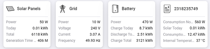

Yes it works well but I don’t see the live production, only the daily total
Do you mean the live production is missing or doesn’t update?
What device have you added from the app?
Yes the live production is missing
sofar 3000tl-g3
Only the total today :
That looks like the summary. To see the solar panel production information in real-time you need to add the solar panel device as well. The devices are split so that it works well with Homey’s energy reports.
This is my setup with the devices added to the favourites:
