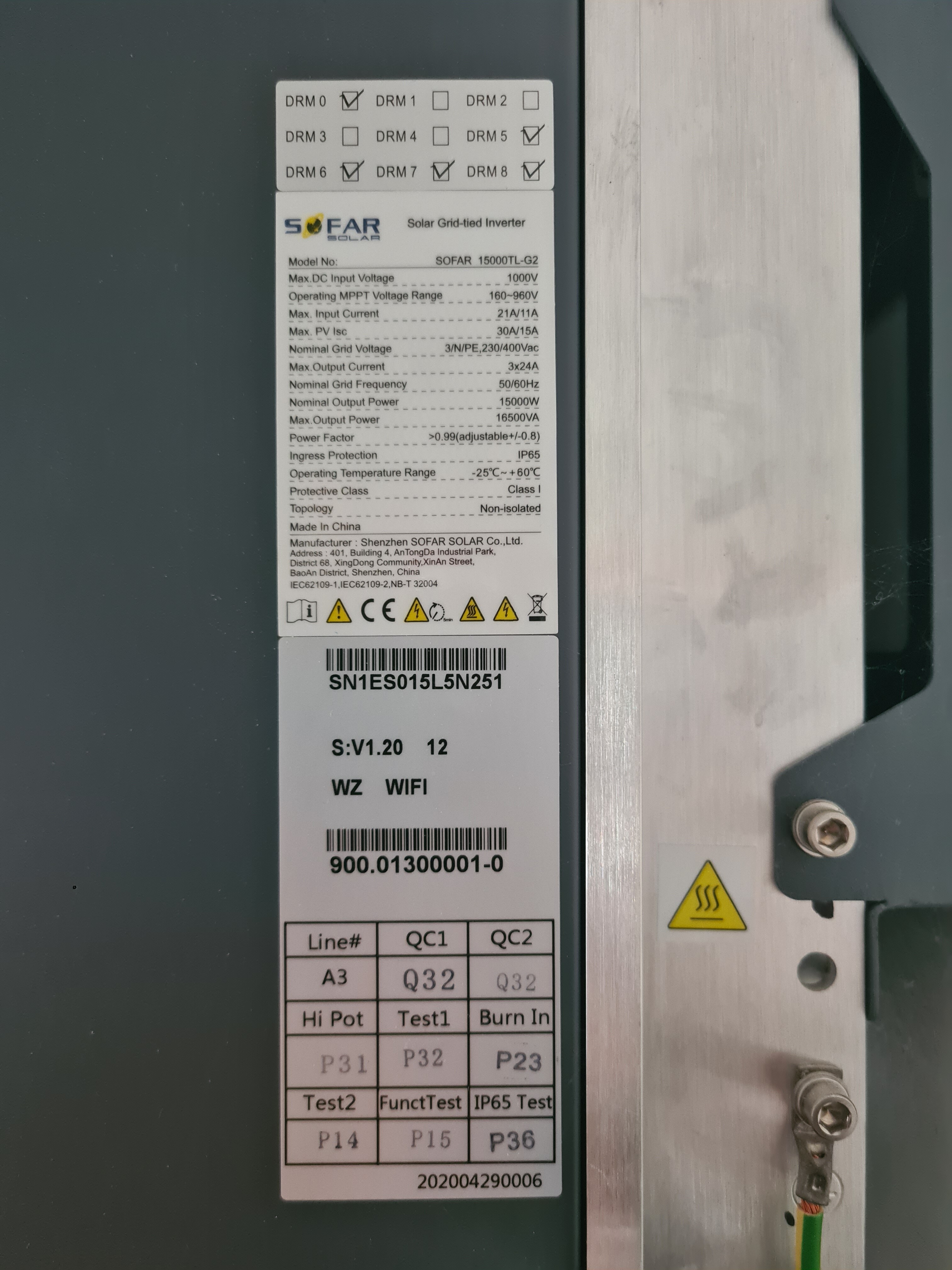

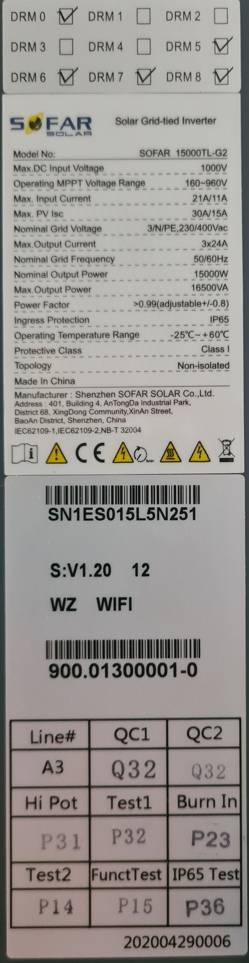

I noticed that a new app with a slightly different name has appeared. This app could not find my inverter. Could it be the fact that v1.1.12 has not been installed and now Homey has both Sofar Solarman and Sofar app? At the moment, I cannot transfer the solar production information to Homey, and I would not want to immediately start buying a separate device for this purpose. Is there any hope that after some time my inverter will start transmitting data to the Homey application using your Sofar app? I am attaching a photo.

The new app has this same local support but dropped the Solarman support as they have blocked my developer account again due to too many calls.
So if you were connecting with one of the local devices, then either app would still work.
I will do a search to see if I can find a MODBUS map for the device you have shown.

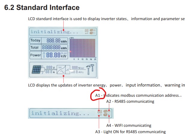

The manual for the Sofar 20000TL-G2 shows where you can find the modbus communication address on your display. It seems the same for the 15000TL-G2
Modbus address is shown in the display, but maybe only when in initializing state (when being powered on only). And it appears it can be set under Address in the settings. Important: you cannot read the address, you can only set it here.
Setting modbus address:
Users press “Back” button to enter “1.Enter setting” interface, Press ”OK“ button to enter main setting interface. Enter “9. Set Address” by pressing “Up” button or ”Down“ button.
Press “OK” button and enter setting interface “Success” or “fail” is displayed after setting
