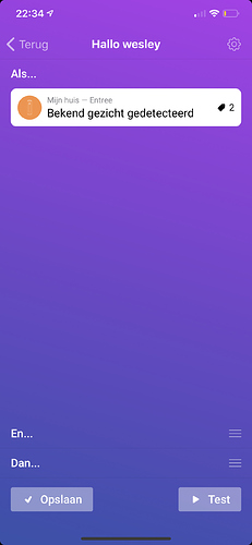

Hi am i doing something wrong i want to let homey say Hello with the persons name when its recognized. Just got my homey and it’s all a bit new.
Sorry had to place in two posts
