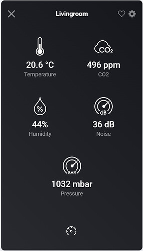

Anyone got the Co2 unit working?
I don’t know about a CO2 module but my Weather station is perfectly reporting CO2, both base Station a s all three extra units. . For what I heard the Home Coach also works and reports CO2.
