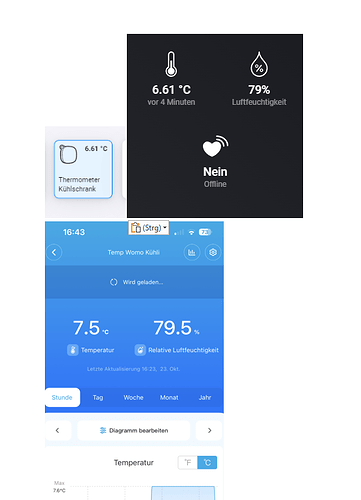

i have a wifi thermometer and use the cloud api key. the thermometer was found.
Unfortunately the temperature is different from the one shown in the app.
any idea?
@Kaoh : no idea? different values of Thermometer via Homey and direct.
THanks
Sorry missed it, the app uses a more love collection than I can through the cloud api, those are pushed to the cloud per period you set in the settings on the govee mobile app. Could that be the reason? If the temp changes quickly you might get these differences. How long is it set?
no, thats not the reason, its a fridge which has a very constant temperature. the difference is always approx 1 degree…
