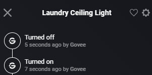

One remark I found so far: their on/off status does not seem to be synced correctly.
Example:
I turn the light on in Homey, and it turns on. A few seconds later “Govee” app indicates to Homey that they are turned off again (unexpected), however, light still on (desired).
Not urgent, not a must, but if there is some time, perhaps this could be investigated.

Can you also send me a diagnostic report sheet after replicating this bahavior?
I can not replicate this with my lights
Procedure:
  • Turn OFF
  • Wait a few seconds
  • Turn ON
  • wait a few seconds
  • Govee App reports OFF again (unexpected) while light is still on (desired)
DiagID: 61bd5f6e-e0b2-4b1d-bf28-c1e406b7f597
There is nothing in the log that indicates wrong behavior. Really weird, no errors and normal states :frowning:
