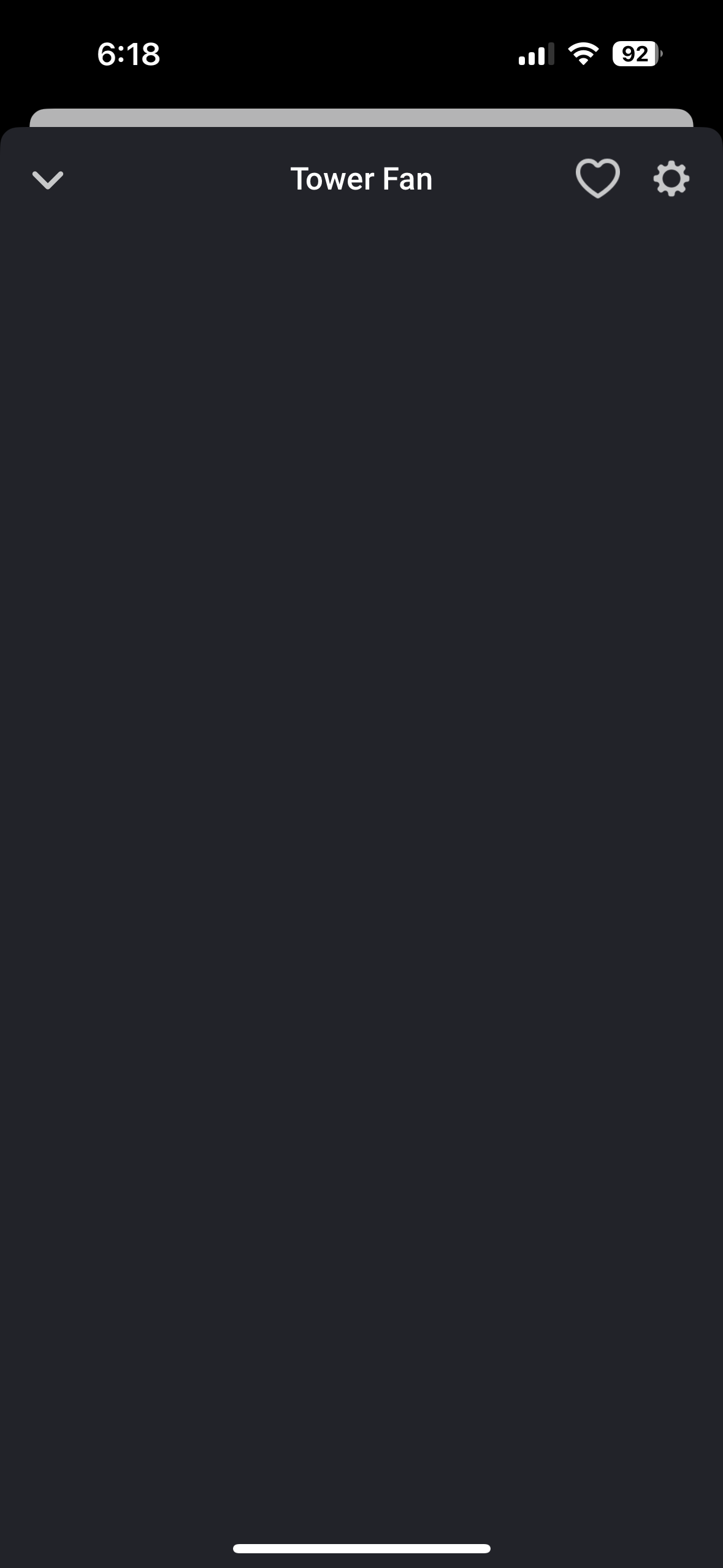

I tried adding my Govee appliances. It looked like they were added correctly,but then got an error. (I’m using an iPhone 14 with iOS 17.2.1)
When I tapped on one to access it, the item appeared, but there was no way to do anything with it and there were no controls at all showing. I tapped settings, favorite, close, nothing happened. I had to close the app to get off that screen. (See next post. I can only embed one image in a post.)
I tried deleting the app, reinstall and tried again, but same result. After that, the other devices I had got messed up and wouldn’t add back in again. So I had to reset the Homey Pro and reset it with a backup. All the other devices (lights) were back and working.
Here is second screen.
That is very strange behavior indeed.
I can’t test the appliances, since i don’t own any of them. I build those blind.
I hope someone here can confirm if they work for some people.
