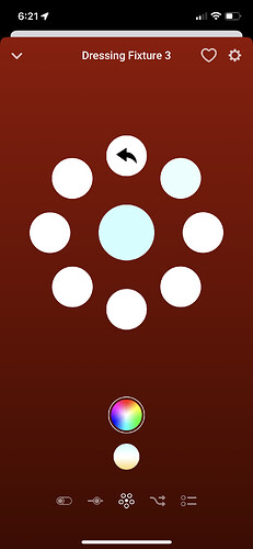

@Jamie that homey swicthes back to saturation UI instead of color is not something I know how to force on Homey devices, do you have a idea on that?
So it managed by setting the “light_mode” capability, I am wondering if because you are doing polling that the value is changed … but when you poll it is over written, might need to manaually set it on poll result? I had a 2 second look at the API I didnt see anything that tells you if its (govee API device) does seems to have different formats depending on the mode

I willcheck out the color mode thanks.
The colors changing back should be solved in the new release of last night.
So this color_mode should be the last issue next to the throttling.
