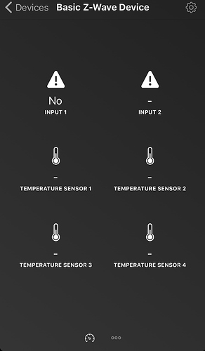

has anyone managed to get the Fibaro Universal Binary Sensor to work with v2? When I add it it ends up as a basic z-wave device and I can’t get the Input 1 or Input 2 to change state in Homey.

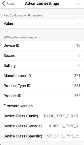

I have Homey 2.0.0 and the Fibaro app 2.1.19. Product ID:
It looks like the Product Id (258) of your unit is not included.

May I ask you in which country you are using your Homey? Different regions have different z-wave frequencies hence, different product IDs for the same type of product.
Thank you! I will report this to Athom. I am usine my Homey in Sweden.
Interesting! Sweden has the same z-wave frequency as the whole Europe so your Universal Binary Sensor should have the Id already included… unless Fibaro has given it a new Id.
