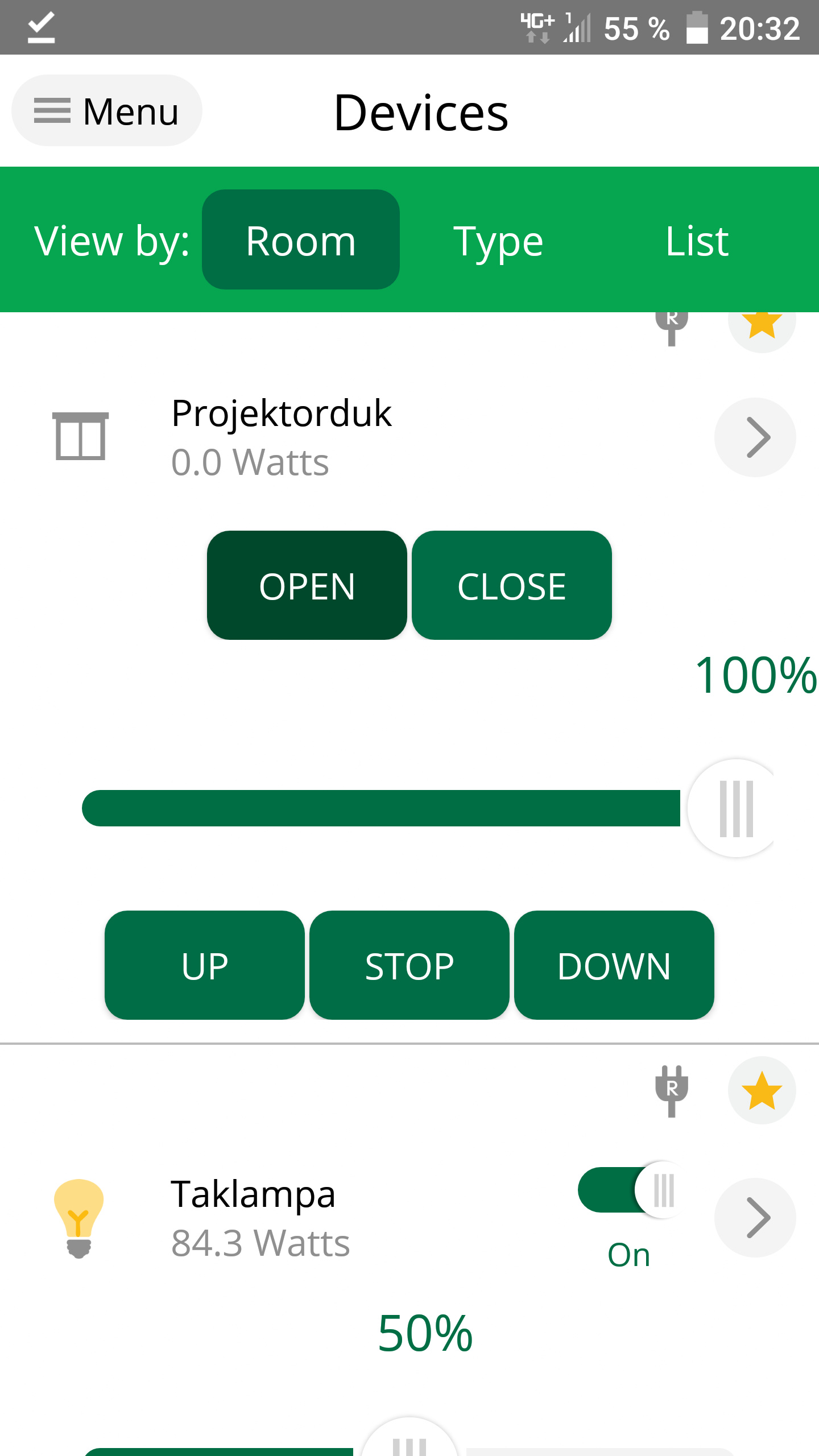

Hey guys. Im considering moving from Vera to Homey. One of my concerns are the listed partial support for Fibaro Roller Shutter 2. In vera I use the up/down/commands. But I also use the feature that it reports back the status of the shutters positions, plus that I can freely set its position and it will go there. Is this supported with the Homey? This is a screenshot from the control on Vera

I cant comment on the Roller, but the Singe Switches (2) and Dimmer (2) both work well at reporting power usage.
The Dual Switch 2, will correctly report the power usege on the (S/Q-1) but the second switch doesn’t get reported.
This bug was first reported a year ago, so I wouldnt hold your breath waiting for it to get fixed.
The position reports are wonky within the device interface as they don’t update the position within it. The workaround is to use Tags and to push the final position to me every time I move the blinds.
Also the UP DOWN STOP buttons also are not as responsive as I’ve liked to be honest. So I’ve set up virtual devices to preset my blinds position instead of fiddling around the settings.
As of the latest update, roller shutter 3 isn’t supported and FGR-222, Roller Shutter 2 only v2.5 appears to be working correctly. My older roller shutters are working but the UP DOWN setting is reversed.
