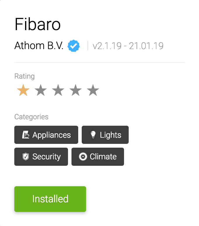

Make sure you create a ticket so Athom are aware that their most ‘popular app’ that they are advertising on facebook and social media as “work seamlessly together” doesn’t actually work correctly if you use the very popular dual swtich. :
These issues were first reported (that I’ve seen) back in January 2017, So other than leaving a message for Athom that all I can suggest is that you leave a review by clicking up on the ‘stars’ with in the app store. and hope one day it becomes high enough priority to get fixed and work as well as other controllers.
