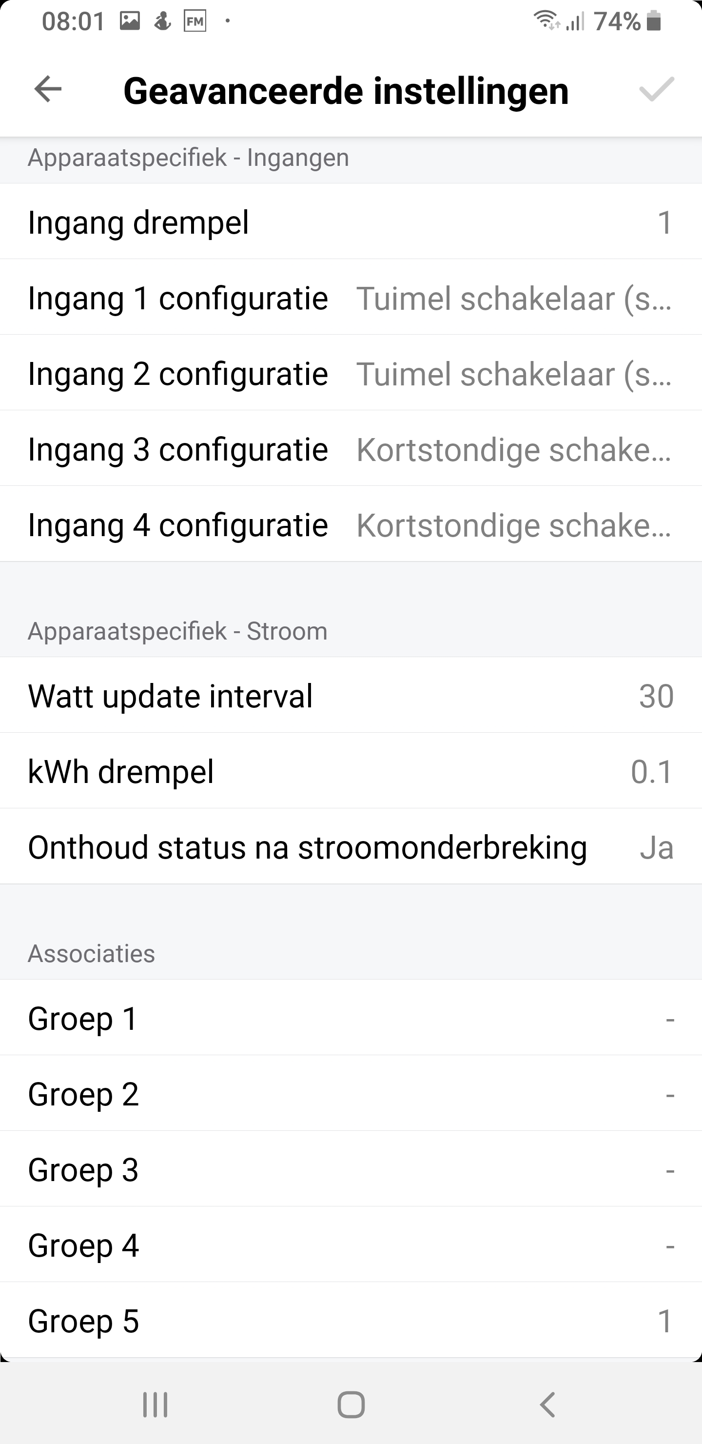

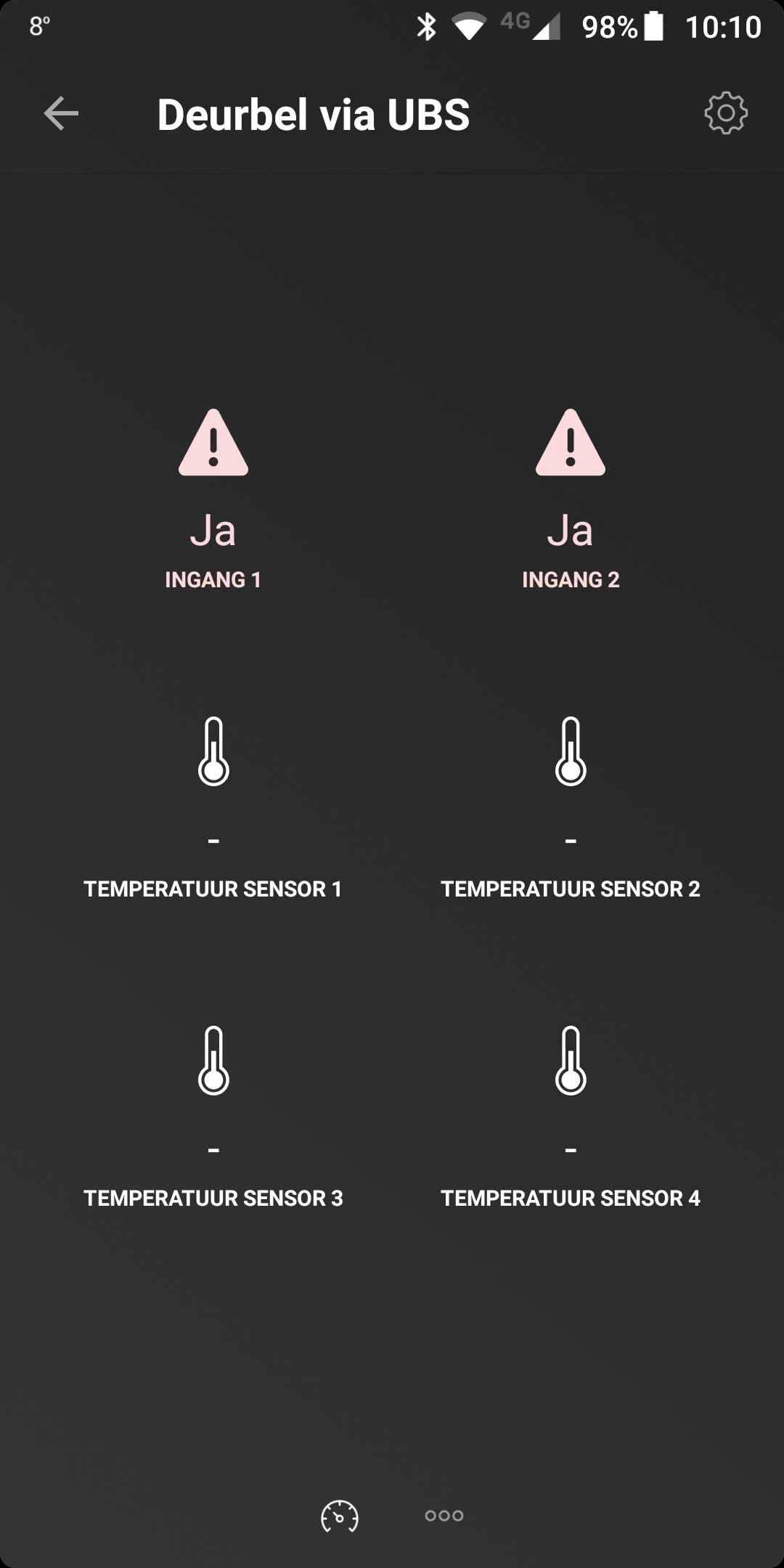

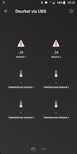

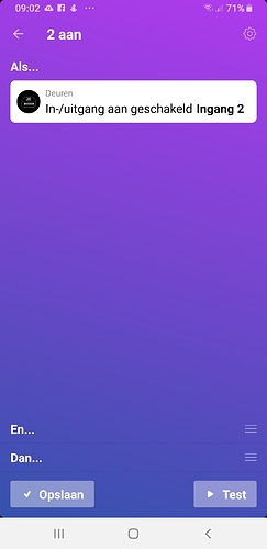

I got a little problem with a Fibaro RGBW controller.
I am planning to use only the 4 inputs. I already have 2 magnetic door switched connected to the first two inputs. As you can see in the image below, the signal comes through.
However, when making a flow, the flow doesn’t get triggered.
Some of the settings:
Already tried different settings but this doesn’t help.
Only way to trigger a flow is setting the configuration to Analog input and then let a flow trigger when voltage is changed… But this is not the way it is supposed to be.
Ik hope someone can help me.
Thanks!
Also when i take out the wires it doesn’t work. The voltages stay at 0,1
When i switch to different configurations for the inputs, i can get the voltages to 0 but still it doesn’t work.
