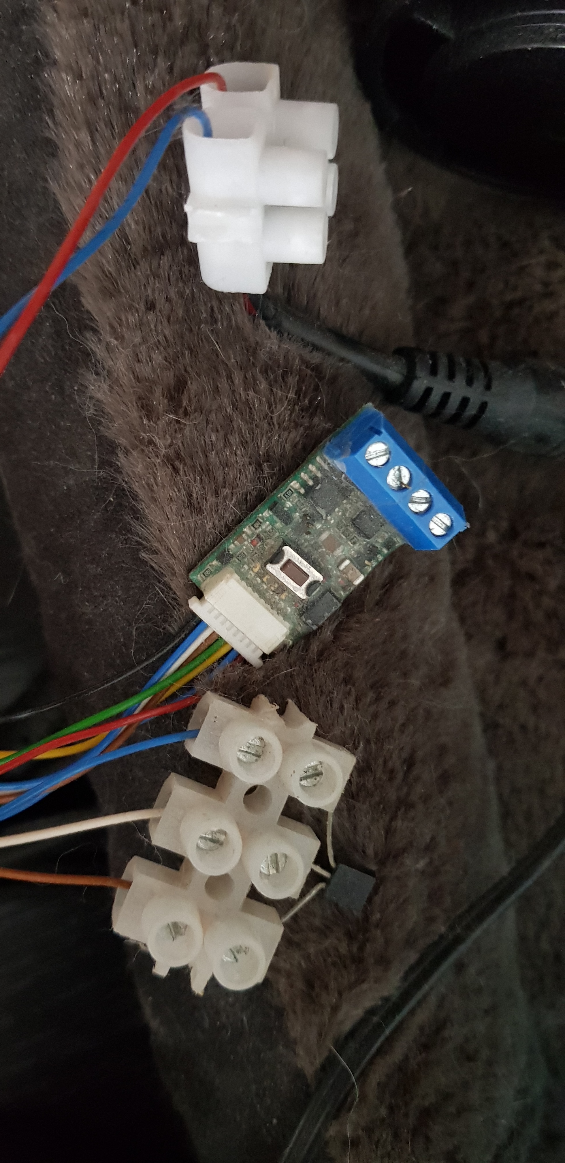

Fibaro universal binary sensor v1 still not working.
Tried inclusion many times and failed, thought it was dead. Turns out i had to delete it in settings/z-wave/remove device. So after about 4 years it finally works again, but got added as standard z-wave device.
Came from vera1 to Vera light to homey backer edition to homey pro. Things improved a lot and firmware update still not allowed by fibaro it seems.
