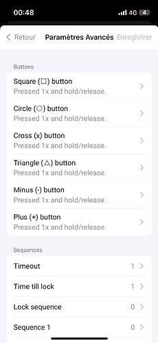

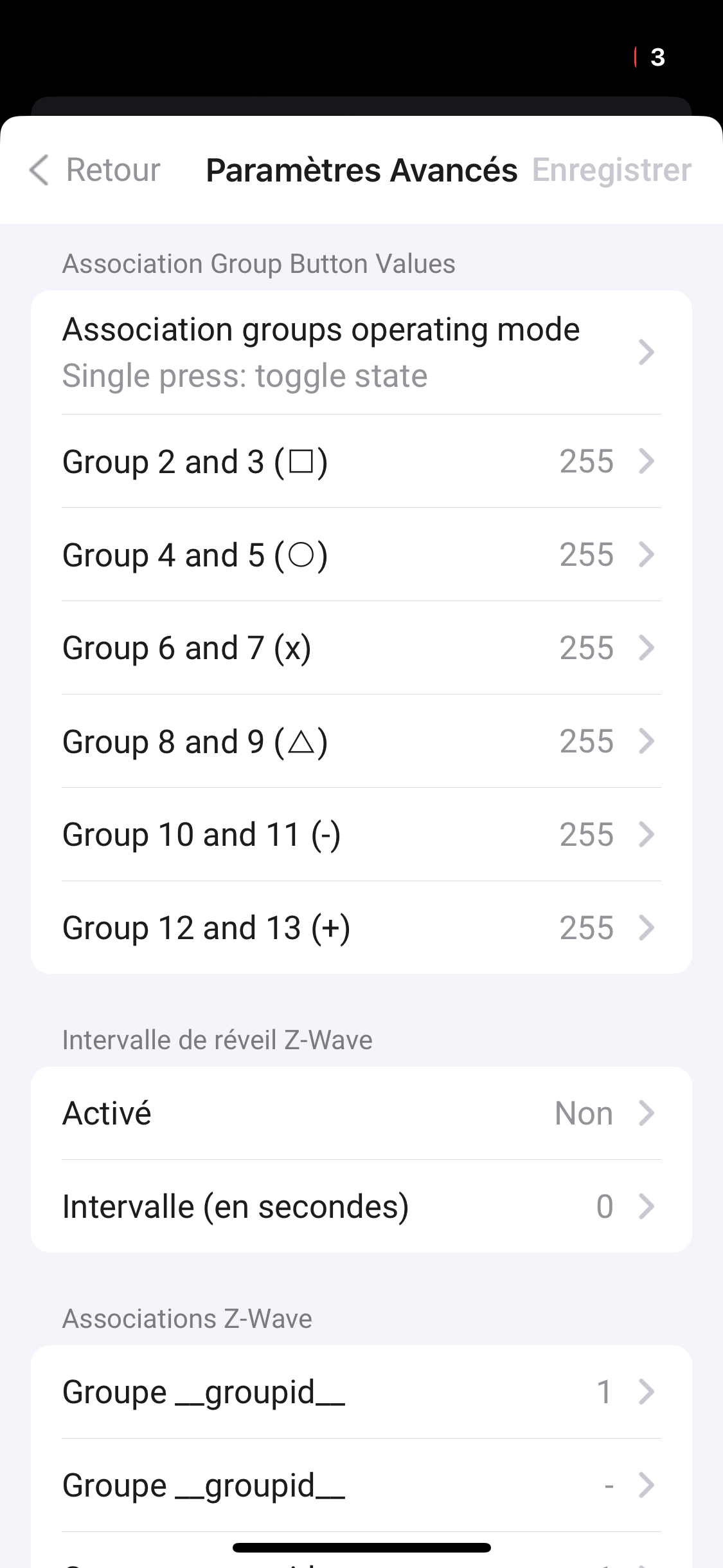

Hello HOMEY PRO TEAM,
Does anyone use the Fibaro Keyfob ?
I bought two Fibaro Keyfob one month ago and I have the same problem with battery consumption : 100% percent with new battery, after 7 days battery is off 0%
I created flowchart with simple « long pressed » scenario on each button
For example : long pressed on « square » = open garage door… long pressed on « circle » = lights outside ON …
I didn’t change default configuration as you can see on pictures.
Any ideas to resolve it ?
Someone has the same problem ?
Thank you for your help

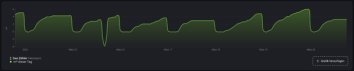

As it didnt work back then, i used an old door/window sensor with a Reed contact. Works and to my surprise doesnt empty the battery (68% after 6 months).
I’ve created a counter ‘Gasometer’ to show the count (It deviates when homey is off).
Bildschirmfoto 2024-03-20 um 19.29.54
I use power by the hour to get consumption and costs.
To my surprise it detected the ‘Gasometer’ when Gas consumption was picked automatically.
