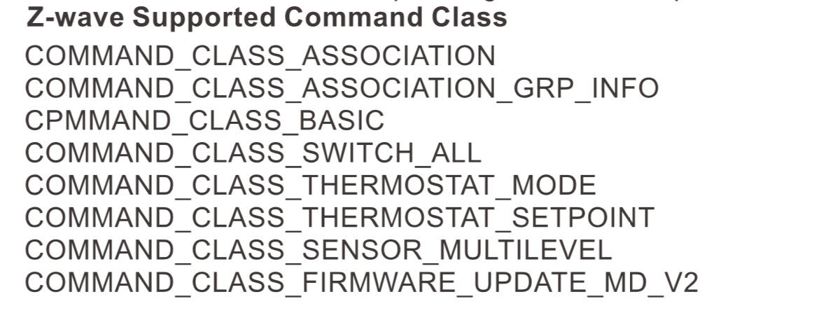

It does appear to be part of the standard. This is from my TKBHome thermostat manual.
Notice the firmware upgrade command.
Homey does technically support OTA for Z-Wave, but theres no app nor build into the core for it that utilizes it, as that’s a lot of work to implement.
But technically it could be build.
It is indeed part of the Z-Wave specifications, but just knowing how to send it, and having the update itself are 2 different things.
It is trying to drive a car, but you don’t have any fuel.
A lot of the manufacturers just don’t give the data, and there is also no single place where everything can be found for the manufacturers that do.
On average it is over 4000 commands that should be send, and verified, so just coming up with update information without bricking the device is worse then trying to win the lottery jackpot.
1 command wrong is enough to brick a device.
So myself wouldn’t trust Homey with such responsibility, it can even fail with sending 50 commands.
I’ve looked at all the fibaro zwave manuals I can find and none of them detail the supported commands in the same way that other vendors do. They’ve got to support the standard commands though.
It ought to be possible to get homey to support zwave upgrades as a standard feature.
