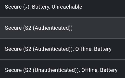

You can find infos about the security standard for example in Homey Developer Tools.
Go to Z-Wave and then you find a list of all your Z-Wave devices. On the right side of the table you can find infos about the Z-Wave security standard of each device:
Bildschirmfoto 2021-10-01 um 12.22.33

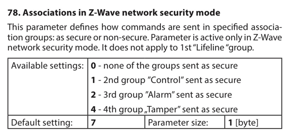

Out of the Fibaro flood sensor manual.
Fibaro Flood Sensor Secure and Fibaro Plug unsecure No Problem, just adjust Parameter 78.
Fibaro Flood Sensor unsecure and Fibaro Plug Secure. No way!
Both devices secure (same security standard) or both unsecure also no Problem.
