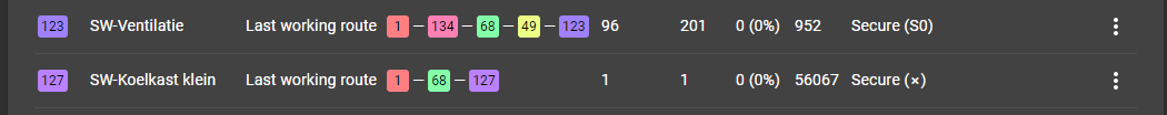

I re-included one wallplug v2 and it shows as “Secure (x)” while the non-re-included wallplug v2 shows as “Secure (S0)”
It doesnt make sense
It doesn’t make sense, but it’s correct.
The WP with NodeID 123 was included with Homey Firmware < v7.
The WP with NodeID 127 was included with Homey Firmware v7.
Since v7 there are 2 new tags regarding the security standard:
S2 devices will always include as S2, unless specified differently by the developer (new tag).
S0 device will always include as unsecure unless specified differently by the developer (new tag).
So if you exclude NodeID 123 and include it again, it will be included as “Secure (x)”.
Just to expand on that more, there are 4 “options”
Secure (x) (also known as unsecure)
Secure (S0)
Secure (S2, Unauthenticated)
Secure (S2, Authenticated)
