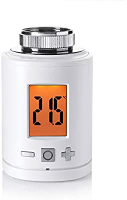

are you sure it is from Eurotronic Technologies?, and not just a look-a-like, as the manufacturer ID is from a different manufacturer (according to the z-wave alliance the manufacturer is Aeotec Limited).
The “spirit” type of valve has several re-brands, and don’t necessarily work the same
Strange.
Yes I am. I bought it as Eurotronic Spirit from amazon, the box says Eurotronic Spirit with EAN 4260012711301 and it contains a leaflet from Eurotronic; and the device looks exactly as the Spirit on the Leaflet and on the Eurotronic website.
sure, but also looks the same as aeotec’s :wink:.
But kinda second guessing if i should add it into my app, as people that do buy the aeotec version might get the wrong app used.
have checked their documentation, and seem pretty similar except for 1 command class that is different, and as the aeotec’s documentation is a bit lacking makes the decision harder.
i’ll add it to my to-do list to add it, but will have to do more research first, so can’t promise anything.
if they are similar enough, i’ll add it.
Maybe you can share the amazon listing, as that might give more clues, or that they just f*ed up.
I got this one:
But I googled a bit with your info and found out that some guys experienced this before (in french): https://community.jeedom.com/t/z-wave-demande-de-mise-a-jour-du-plugin-pour-nouvelle-tete-thermostatique-aeotec/7951
According to them, amazon.de randomly ships units from either Eurotronic or Aeotec. And it seems that he was able to get the Aeotec one working as well, the description looks not too complicated.
I ordered the same some weeks before. It was a real Eurotronic. Did you got it in the original Eurotronic package?
