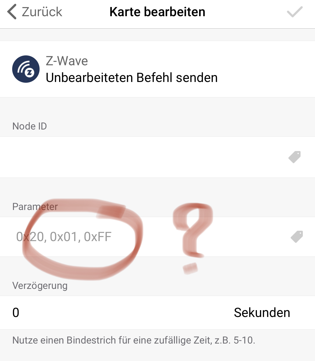

@Caseda if I want to send the room temperature to a Spirit via flow, what do I have to enter here?
I know I can do it also out of the box.
But I’m interested on the raw Parameters.
Thanks a lot.
If your valve is included secure, then that card won’t do anything, even with the right command.
And if it’s include Unsecure?
And how did you managed it within the App?
If it is included unsecure then it is possible, but ill have to search the hex numbers, as I’m not at home this week, I can’t search for you yet.
The app knows your device is included secure, that (generic) card doesn’t
