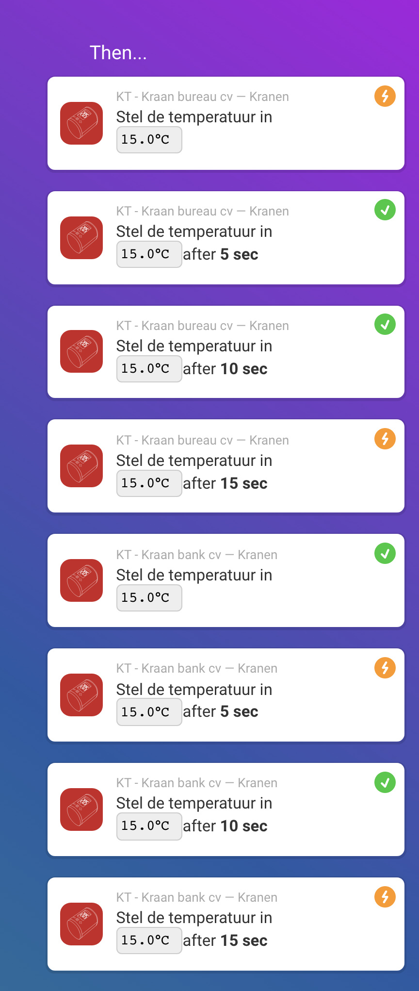

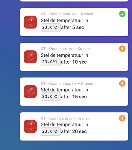

Unfortunately I am having similar issues. All worked well for months, but recently I see communication errors to my Spirit valves. In my flows I have made extra actions card (just in case), but that also fails to work:
Oddly enough, sending multiple commands with a delay is not working great either:
So, the good news? Yes, it can work. It has worked for over a year for me, with only a rare comm error. The bad nes; it still remains unstable and is not 100% reliable.
