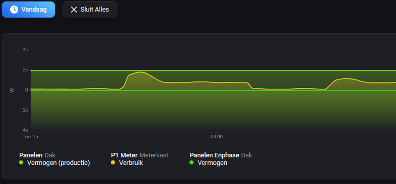

With ‘Zonnepanelen’ I cloud combine P1 usage and PV production in one graph.
The Enphase app doens’t work, Insight says only graphics of the same type (Zelfde eenheid) can be combined.
But if I add it to the combi of P1 and ‘Zonnepanelen’ it does work :
Possible cause:
Make sure to select the power (W) entry.
Not the Energy (kWh) entry.
I did try both, took the same one. Works when the old one is allready there, did not when I removed it first…
Both times ‘vermogen’ you can still see part of the label in the upper graph…

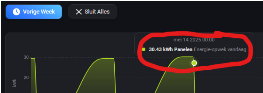

Would be great ofcourse, but this actually doen’t add up :
I restarted ‘Panelen zolderkamertje’(= old app ‘zonnepanelen’ ) just this morning to check…
Yesterday :

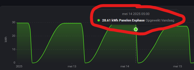

Yep, it’s a bug :
I had the same like the two last pictures from @JohanP
And i had this problem. No update of used realtime power.
And total kWh a day was not reset.
