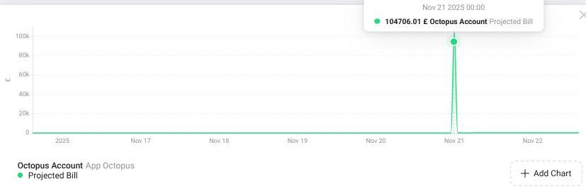

V1.0.29 Interesting “Feature”
The billing period on my account just rolled over. For one minute at midnight, the projected bill was over £100,000. Whoops. A bit of smoothing is required at the beginning of the period… Here’s the “interesting” insight…
Documented as bug #9. The correction will be to avoid calculating the estimated bill during the first day of the billing period. Null will be assigned to the capability when the value is not be calculated - displays as “-” in the Homey UI.
