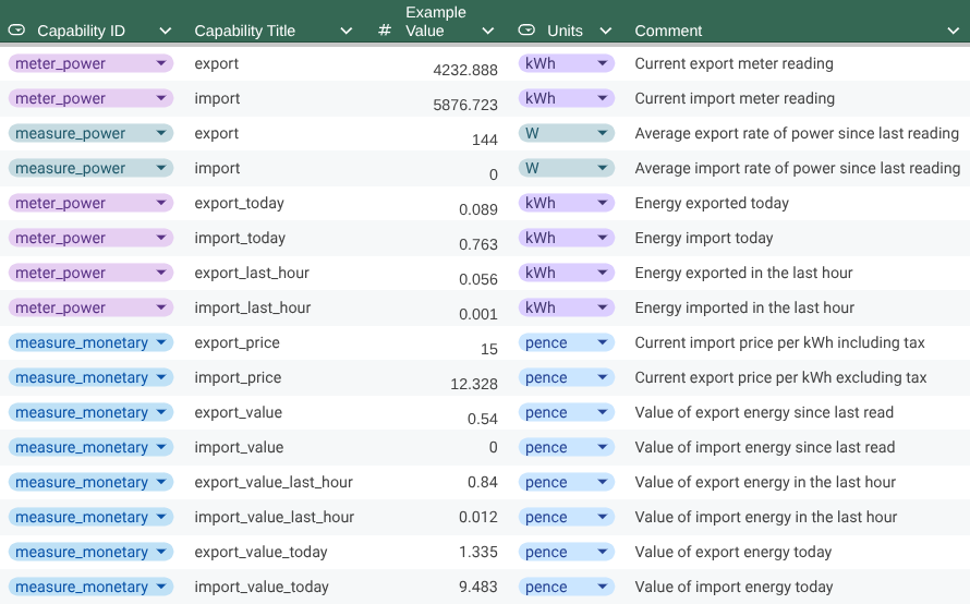

Capabilities of Tariff
Octopus Mini Device
Purpose
Reflects directly the data returned by the Octopus Mini on an instantaneous basis. Additional data is derived per hour and per day. This device could be used to implement the equivalent of an in-house display of energy use and cost.
Capabilities of Octopus Mini

Capabilities of Account
I am unsure of the long-term value of the Tariff device since it only accumulates energy and value by slot (or day if the tariff is constant price). This data is also collected by the Mini and Account devices. Whatever, I plan to implement it and learn from its use.

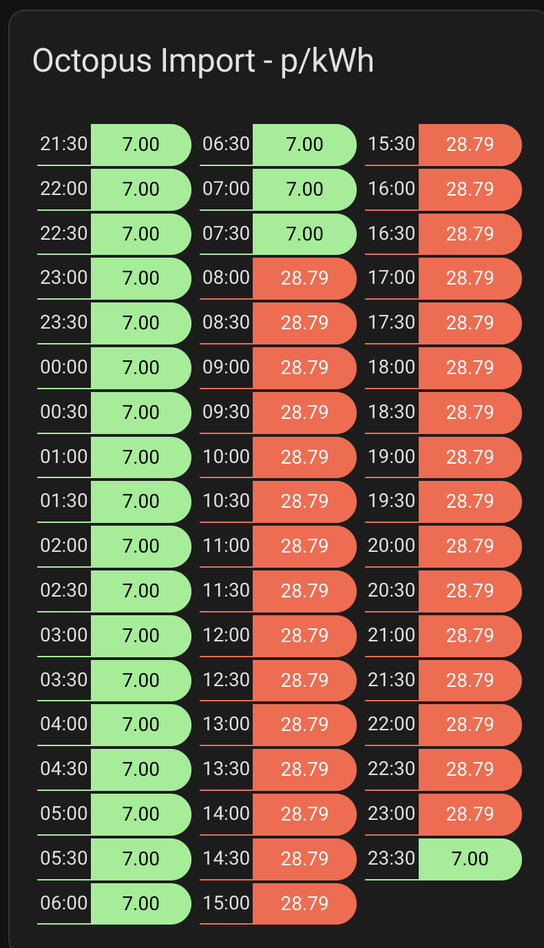

For the prices - with Intelligent Go I only pay two prices.
The full rate of 28.79p or the cheaper rate of 7p. I currently use Home Assistant to push the ‘Current Price’ value through to Homey so I can then trigger automations. It’s one of the only remaining functions of my HA Install - I’d much rather move it to Homey and shut down my HA instance.
Here is the screenshot of some data I get on my Home Assistant Dashboard.
With Octopus Intelligent Go - when I plug in my car, it communicates with Octopus who then schedule my charging with cheap windows.
When I plugged in today, it gave me times such as:
3-3.30pm
7-9pm
10.30pm Onwards
Each of these slots would be at the cheap rate.
So then I use my Homey / Homey Assistant to detect when the rate is currently cheap, and charge my Tesla Powerwall Battery along with a few other devices around the home / control the air conditioning in the Summer when it’s hot, house is boiling + we are exporting excess to the grid.
I’ve not seen much in terms of the free price windows on Home Assistant, although I haven’t ever gone looking - but thought I’d mention it!
