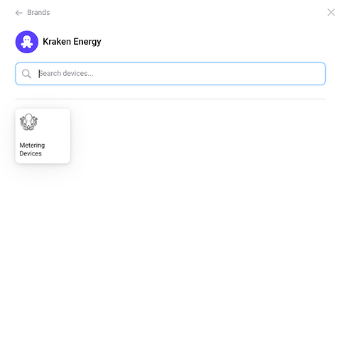

Driver Selection
There is only one driver despite having three different device types…

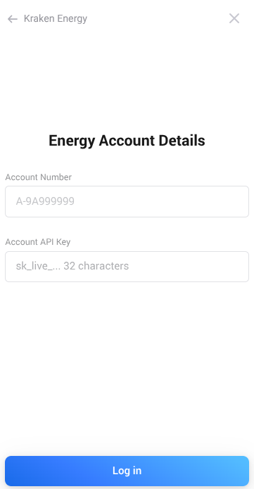

Account Credentials
Still frustrated that I can’t get the app icon to display on this view.

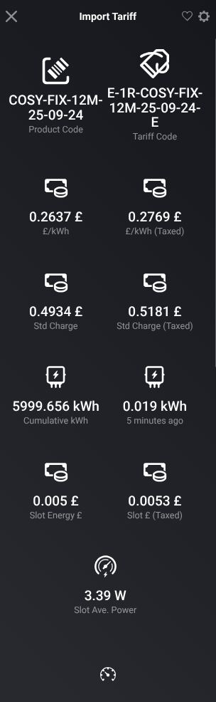

Screenshot of the capabilities for the import tariff (click ⯈ to view the image)

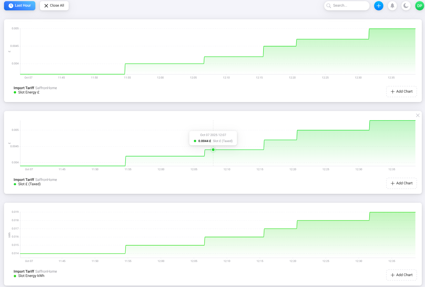

Straightened my head over capability naming and now have a good working alpha for half-hourly priced tariffs.
Capabilities (top and bottom halves…)
A few insights…
