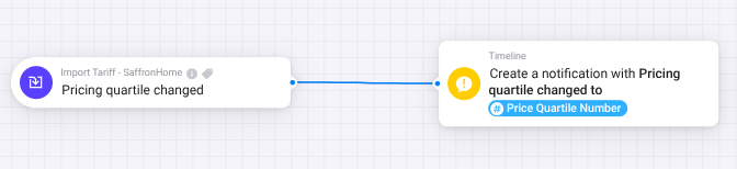

First (trivial) Flows
Useful Trigger flow cards for the Octopus App:
And:
