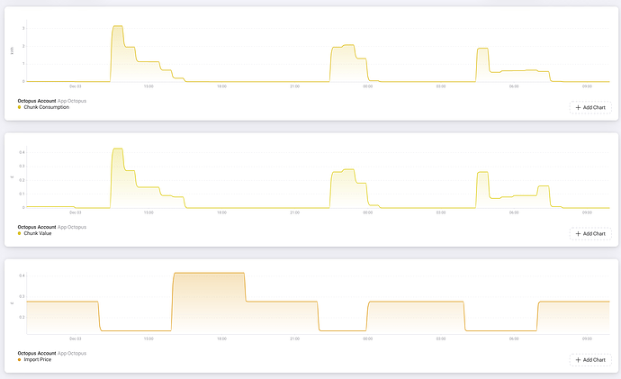

In addition the device displays the Import Price - when a dispatch is active, this will show the Dispatch Unit Price; when a dispatch is not active it shows the normal Tariff Unit Price. Two additional capabilities are added - Chunk Consumption and Chunk Value. The term “chunk” is being used as the label for the 30 minute periodicity imposed by the UK Smart Metering network.
These two capabilities will be of interest to @Brettus_Maximus. If you plot the insights of these two capabilities you will see consumption and cost per half hour. Note it’s half an hour “in arrears” because at 10:00 (for example) Homey logs consumption from 09:30-10:00.
Here are my insights for the last 24 hours…
Alongside pricing information - notice how consumption aligns to the lowest price :grin:
