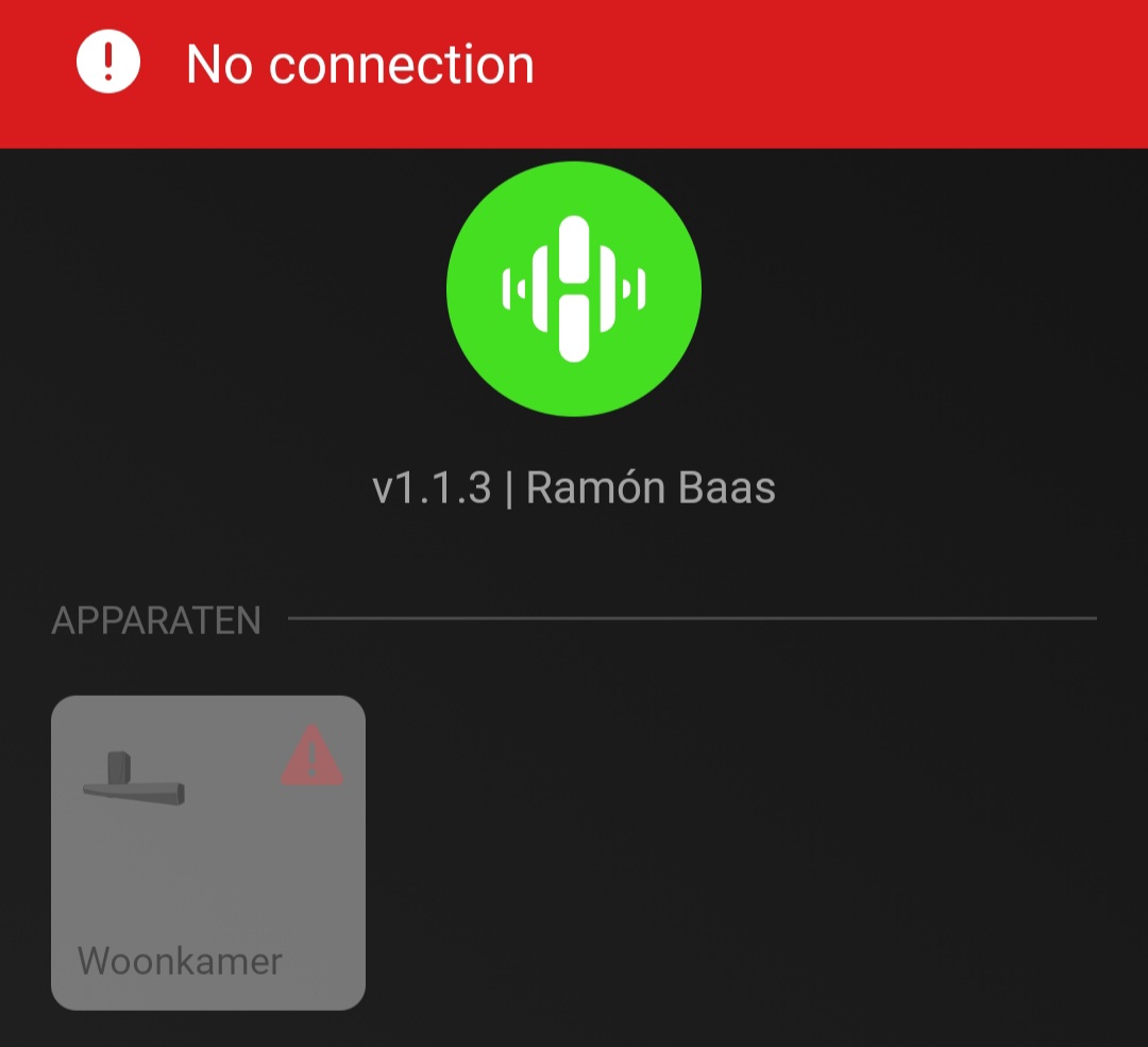

I also have an issue that a lot of times the device is unavailable/no connection error, after an app restart it works again. Any idea how to prevent this behaviour. It looks like it happens when I start homey and the Denon heos homecinema is still off. Or it is because I turn most of the time the speaker off with the heos (android) app.
I would expect this D&M heos app can start the heos device, like the heos app (Android) can?

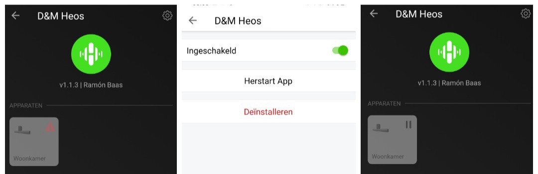

@nlrb The app doesn’t crash, it just loose the device (heos homecinema). When I restart your app, the device is seen again. No idea why…
Edit: picture added.
This what I do every day. App says connection error. I restart the app and heos speaker is available.
