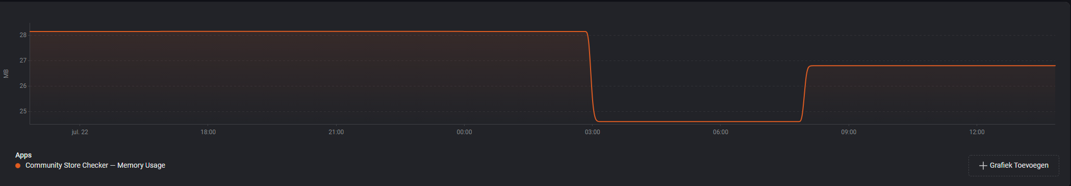

Hi @Adrian_Rockall, I have to come back with the memory problem.
This is a chart from the last 24 h:

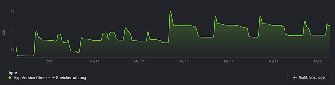

Last 7 days:
The peaks are at the time of the check, but only ever every 2nd day.

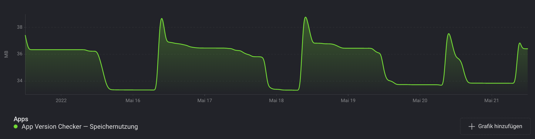

Last 14 days:
Is there anything you can optimize? After the query it takes a very long time for the memory to return to normal. But even then about 34 MB are used.
