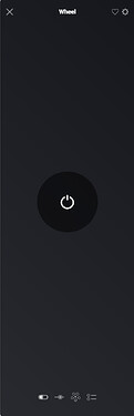

Today I noticed that the state on/off of the light is not synchronizing properly between Twinkly and Homey.
Flow:
Homey:
Twinkly app:
I used the Twinkly app for testing purposes and the Homy status also did not update when the light was turned on/off. Manual on/off from Homey shows the correct status on both sides.
There recently was an update to the API backend. Are you on the latest version of the app?
It should be v4.3.4
If you have this version already. Please file a support request through Twinkly’s official channels.
A version of the Twinkly app is 3.15 → no updates available in the Google app store. I was using the Twinkly app to test if the status was correctly updated inside the Honey after turning the light on/off. This was just for the troubleshooting.
The main problem is that Homey doesn’t show that the lights are on when this flow is executed.
Flow:
In the Twinkly application, on the other hand, the status is displayed correctly.
I was referring to the version of the Homey app ^^‘’
The Homey app technically only reflects what the Twinkly API tells it. So if the status is changed in the original app and that change is not reflected on Homey side, then there is an issue with the Twinkly API servers. Please contact Twinkly support on this. This is beyond what I can do support for.
