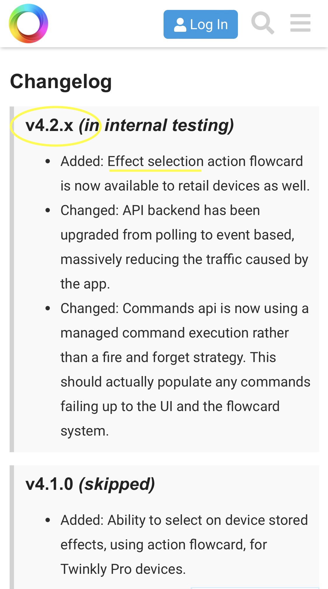

When will the 4.2 version be in production? This because of the most wanted functionality there is; choosing the effect on the date and time you want to!
I now use the 4.1 version, but is there a releasedate for the 4.2 version? Or can I test that version?
Hi @Arjan_t_Hart,
I appreciate your interest in testing. But I cannot provide a test version at this time, as it would not work with your Twinkly account.
We will be testing the new api against the backend the next days. I am quite confident that the new version will be available very soon.

Hello Twinkly fans,
Just want to keep you guys in the loop, as many of you are waiting for the update. Mainly because of the effect selection feature.
So far the testing has been going very well. We are now down to one last test-case, which requires a little adjustment on Twinkly’s end. As soon as everything is fine we will go into public testing, and possibly live release soon™ after. Public testing is currently not possible due to required changes on Twinkly side which are not available to public just, yet. But thanks for asking :heart_eyes_cat: :love_you_gesture:
Please bear in mind that I am not officially speaking on behalf of Twinkly here.
Wish you all a nice 6th Dec. :christmas_tree:

Effectively the Homey app remembers the last brightness value your device has reported to Homey, as long as the value is above 0%. Something seems interesting here though. Homey would actually send a 50% brightness setting if it has not received any update containing brightness data from your Twinkly since the Homey app had started. So Homey would think it is at 0% and when it wants to turn it on it defaults to 50% as turning on with 0% would not make any sense.
I would ask you to watch this when v4.2.x is released as the whole device status update logic is done differently starting with that version. Maybe the brightness information update problem you seem to have is fixed by that already. If not I will have a look at your logs once the new version is out.
