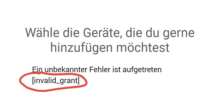

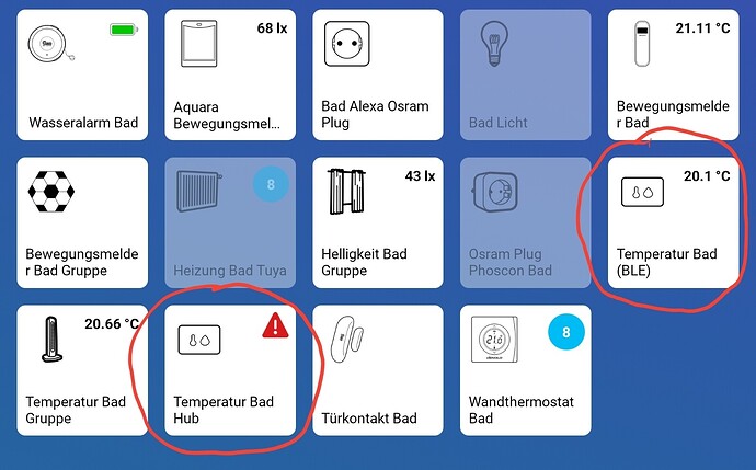

1.0.5 I have just noticed that all Switchbot devices that are logged into Homey via the hub are no longer available… The attempt to delete a bot and include it again is aborted with an error message.
The error has been occurring since the update to the new version 1.0.5.
The same device logged in via Bluetooth works.
Edit:
I found the error myself. For whatever reason, Homey had logged out of the API.
