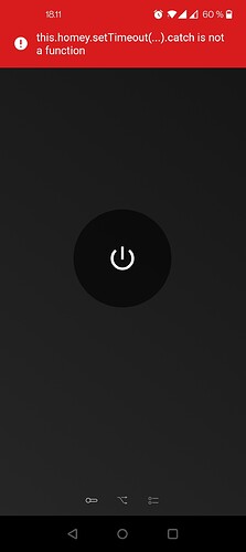

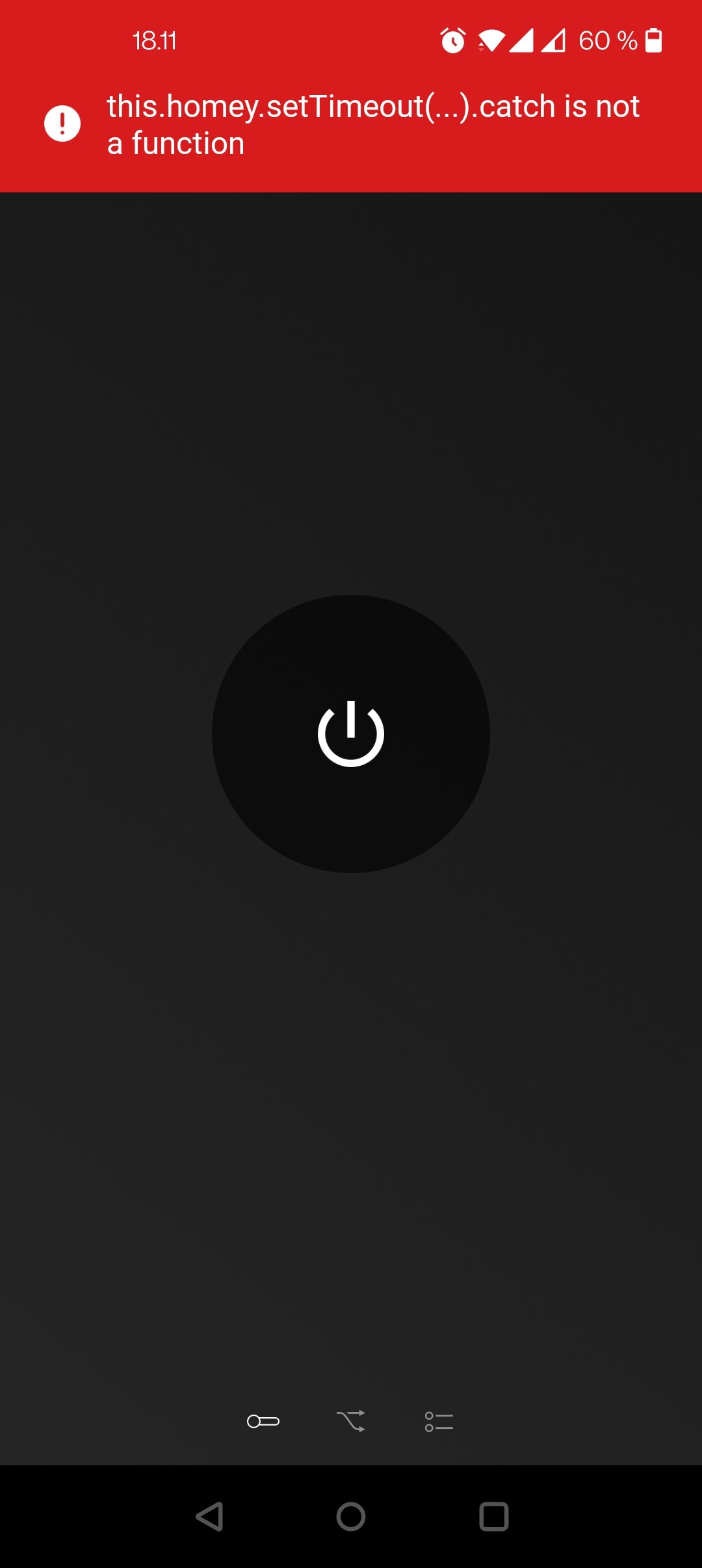

I get a timeout error for my switchbot bots when sending a command.
The hub sende IR commands without problems.
Can someone help me?
This happens when trying to search for devices in homey
Could you try doing a repair on the bot device.
If the app was updated from a pre v1 then it’s possible that it is still trying to use the old authentication method and a repair will solve that.
Thanks for the reply.How do I repair it? Is it in homey app or switchbot app?
It’s in the Homey app. Open the device tile then tap on the :gear: (top right corner). Tap on Maintenance and then Try Repair.

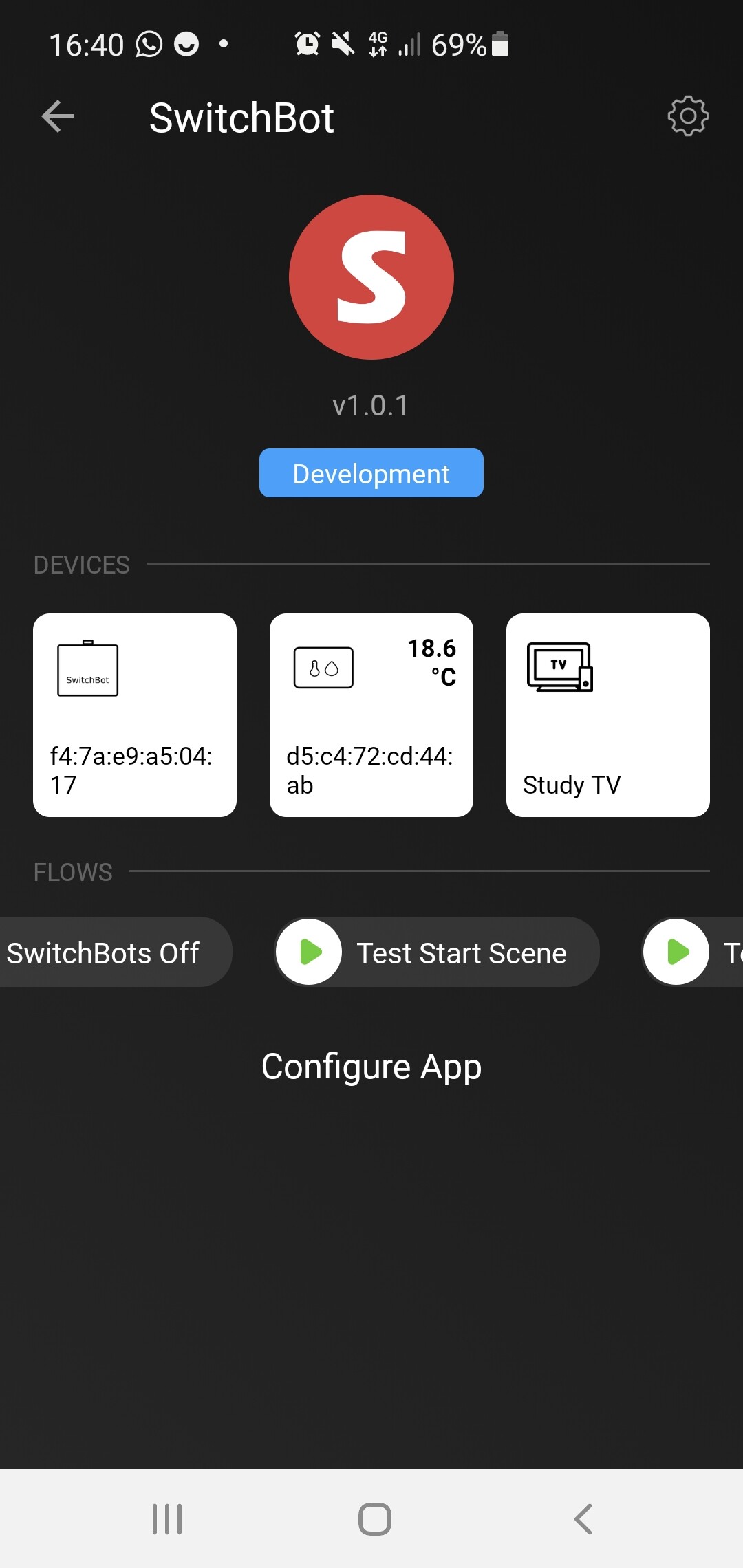

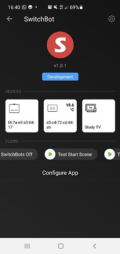

Yeah I don’t have that option🤨 I’m on experimental 1.0.1
That’s strange as I’m on the same version.

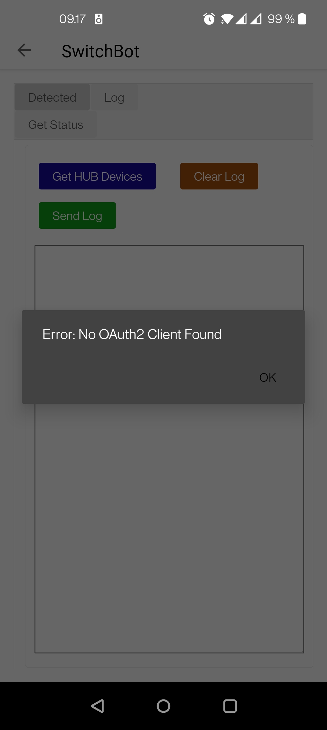

Ok just added bot through cloud and not via BT. I got the option now but it didn’t help.
I get this error
Ah, sorry didn’t realise the first one was via BLE.
I have found the cause of the error and it will be fixed in the next update. Hopefully that should be published to test tomorrow as I still have testing to do on a couple of other changes.
One cause of this problem is if the distance between Homey and the bot is too far so the signal is intermittent.
The Get Hub Devices feature now requires at lest one Hub device to have been add to Homey to create a pairing session. I will try to improve that in the future.
