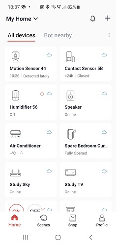

I am a little bit confused now. Sometimes it say there is no hub needed, sometimes its needed. Can someone answer this please :slight_smile: ?
My situation:
I’ve bought one curtain bot and wanted to add into Homey directly.
What I tried:
  • add directly with ā€œCurtains (BLE)ā€ → not found
  • add with "Curtains (HUB) (added API before) → device found and added. But if I try to open/close, a message "Device’s cloud service not enabled. Enabling is not possible without a hub…
The swtichbot app inside homey has some logs, I see statuscode 100 and success in normal requests.
By a command ā€œsetPositonā€, the feedback is statusCode 174 - Device cloud service not enabled"
Am I doing something wrong? Please help. Thanks!
Philip
PS: Ive only tried the official version, not the test version…

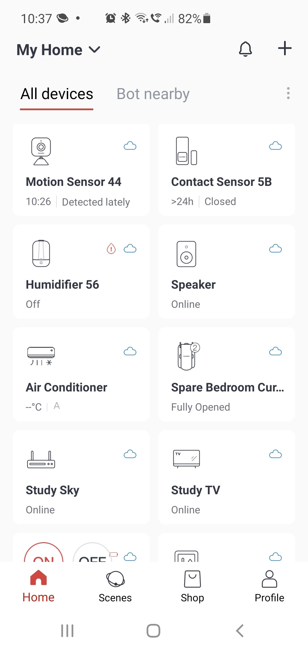

You will have to enable the cloud option for each device in the SwitchBot phone app.
When it’s enabled you will see a small cloud icon on the device tile.
Also, I guess it’s possible the API knows about devices that are added to your account, but without a hub it has no way to control them.
So, without a SwitchBot hub, you can probably see the devices via the API but not control them. I hadn’t realised that myself until you mentioned it though.
The reason the BLE doesn’t find it is probably because Homey is too far away from the curtain bot.
