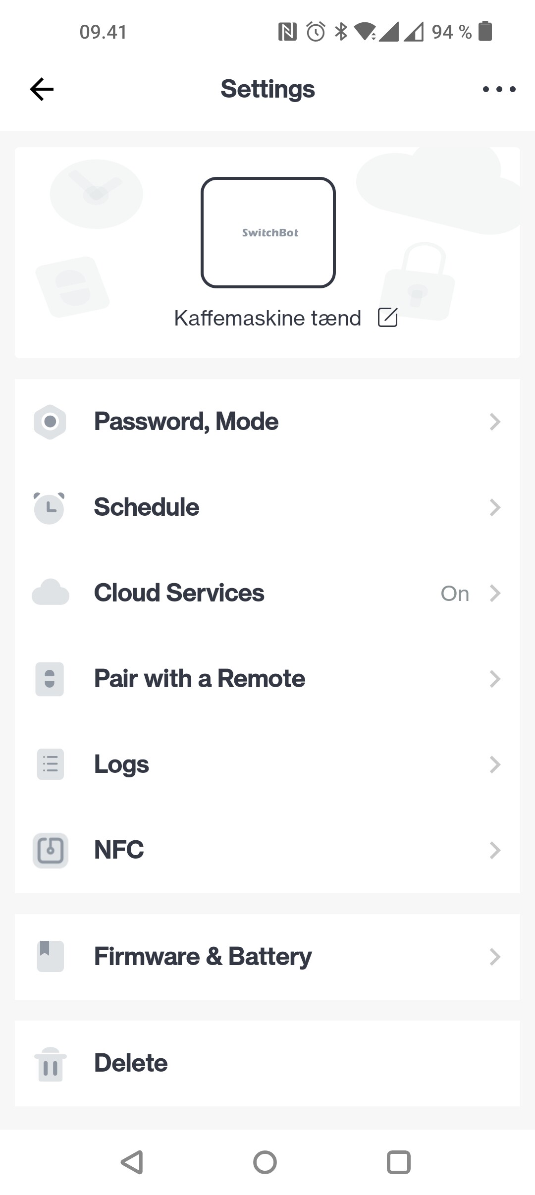

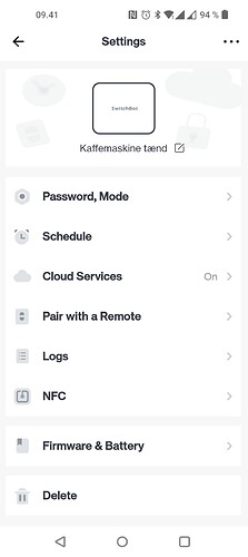

Thanks for the log. Could you make sure the cloud service is enable in the native SwitchBot app?
I will add an error message in the next version if it’s not enabled but at the moment in will fail silently.
It’s already enabled in the native app :pensive:

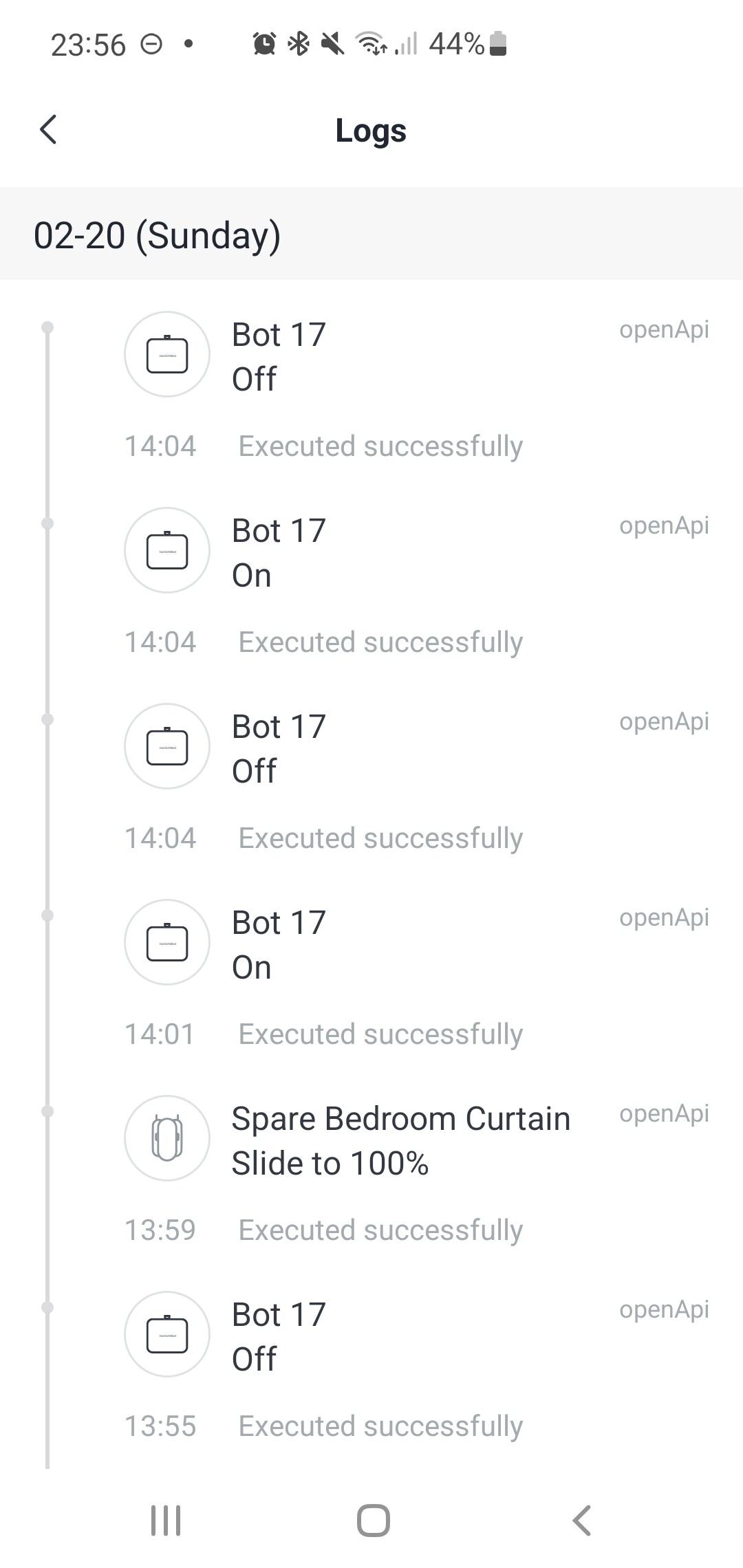

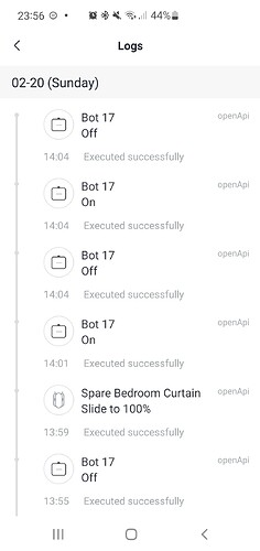

If you open the Hub device in the native SwitchBot app, then tap on the gear in the top right and then tap on Logs it should show you what commands it has received.
If you operate the bot from the Homey app, do you see anything appear in the log?

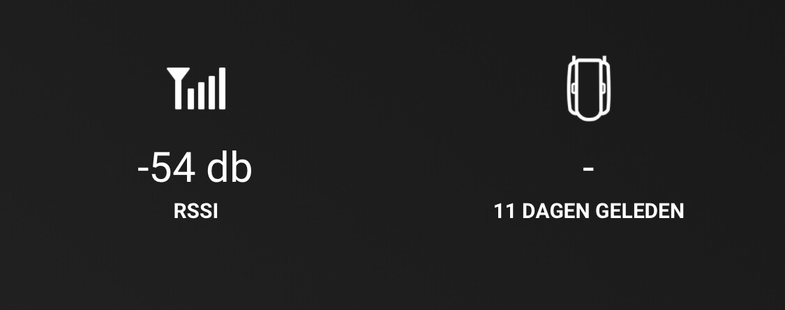

Since 11 days I no longer have a position reading at the curtain bots. This is after the firmware upgrade carried out from Switchbot.
The bots are connected via BLE. Funny thing is that now the cloud connection does show position reading, and that didn’t work before. But I prefer the BLE version in case of internet outtage.
I have already restarted Homey as well as the app and Switchbot Hub. I just haven’t tried re-adding the bot yet. First gonna give it a try here :slightly_smiling_face:
I have just updated my firmware and see the same issue. It looks like they have added extra information to the BLE data so the app is not recognising it.
I will post an update as soon as I have verified the data is not required.
same here, updated today all my curtains to firmware version 3.9 and the position reading in Homey is now broken…
