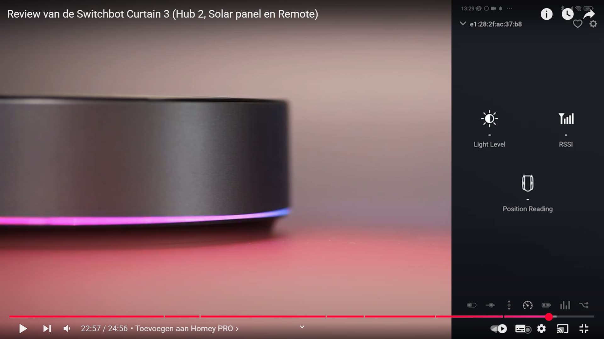

I just installed the solar panel 3 on the Switchbot Curtains 3.
But the solar panel isn’t showing up in Homey.
Am I doing something wrong?
Hi!
I’ve already repaired the app and restarted it.I just installed the solar panel 3 on the Switchbot Curtains 3.
There’s nothing to show as the API doesn’t report it.
For example, in this video you can see the light level with a curtain 3 and a solar panel 3.
