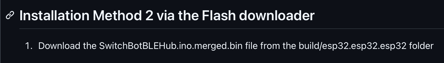

You would normally need to select the SwitchBotBLEHub.ino.merged.bin file. You are flashing a different file; w/o the ‘merged’ part.
Another thing to try: under SPI MODE in the flasher, you now selected QIO. Try if it works if you select DIO.
I just follow the instructions, there it list the use this;
But I will try the merged file…
Oke I used now the merged version file and could setup my wifi network.

Regarding the instruction: I think you mixed up the instructions for the initial installation (method 2):
And the one for over-the-air updates on an installed/in use device:
