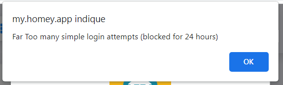

Hello, Il have the version 4.0.32 installed, but I can not loggin.
I have the error 401 or this
can you help me?
The login is being blocked by Somfy for some IP addresses. The message you see means the IP address you have been assigned is one of the blocked ones. The app will try again in 24 hours, by which time the blocked IP will have been removed

Sorry to bump, I have been trying for 1,5 weeks without any luck. (blocked x minutes or hours an 401 error messages)…
I’m hopeful the new update will clear the problem in 24 hours as it prevents retrying by restarting the app etc.

Just to be sure, the issue is during setup. At this stage I have no connection with tahoma services whats so ever as it doesn’t allow me to add a device.
I presume you are using Homey (cloud)?
If so then the issue is because there are many Homey users on each server and one or more of the server IP addresses has been block due to too many failed login attempts. Therefore, every user on those servers will be unable to login.
If you are using a Homey Pro then it will be a different issue.
