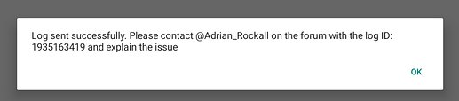

I sent the log to you now, it did populate (late). :slight_smile:
Adrian, Hi,
Do you want me to test anything, I’m on site now. Need 2 hours to fix electrics, after that free to test anything you want.
I don’t seem to have the log. Could you try again and make sure there are no errors when sending it.
