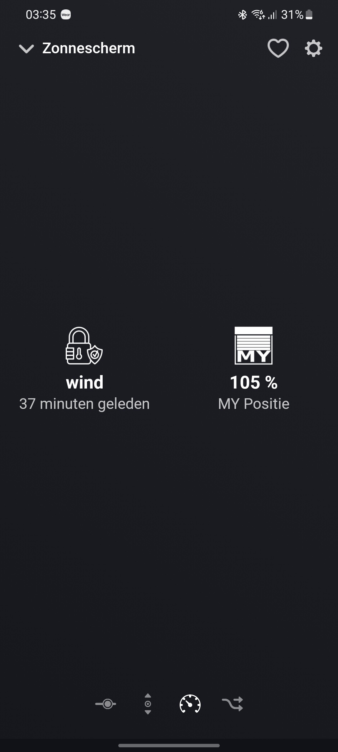

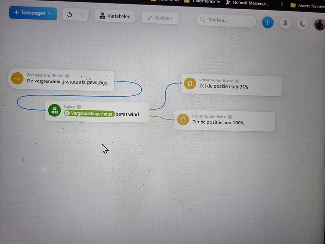

I think you got it. There was a notification on the timeline and the lockstate is changed. That was for the first time in months.But i made a mistake in my flow, so i must test it tomorrow.
Is all else still local?
That worked. Perfect. It was indeed the solution. It is send to the cloud.
Thank you very much. This sensor is more relaible than using the weatherstation to see if there is too much wind. Because of the trees that surround the weatherstation. I only have one question. Do i see it right that the “blockstate” stays on wind even when it is unblocked? Because else i got lower my sunshade after when it is unblocked.

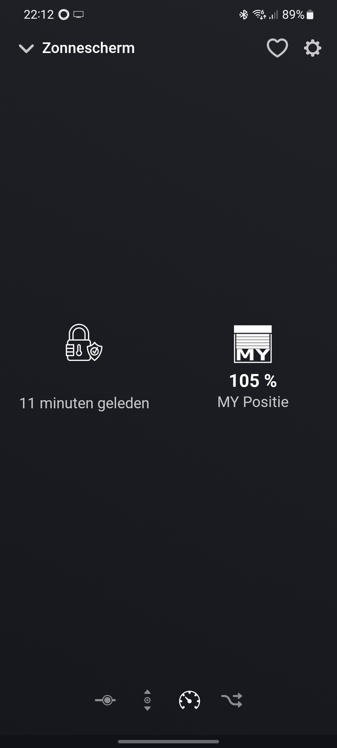

Great. It starts a flow again when to much motion is detected. I let you know if it is opening again when blockstate is off. But this is already more than good enough. Can i give a small donation for all your help, support and including the eolis 3D?
It worked. Thank you. It took a longer time to release the block state. I think because i made too many actions on the sensor. But when the lockstate was released i got a notification on the timeline. And i see that lockstate is released on the device. Something i didn’t see before.
