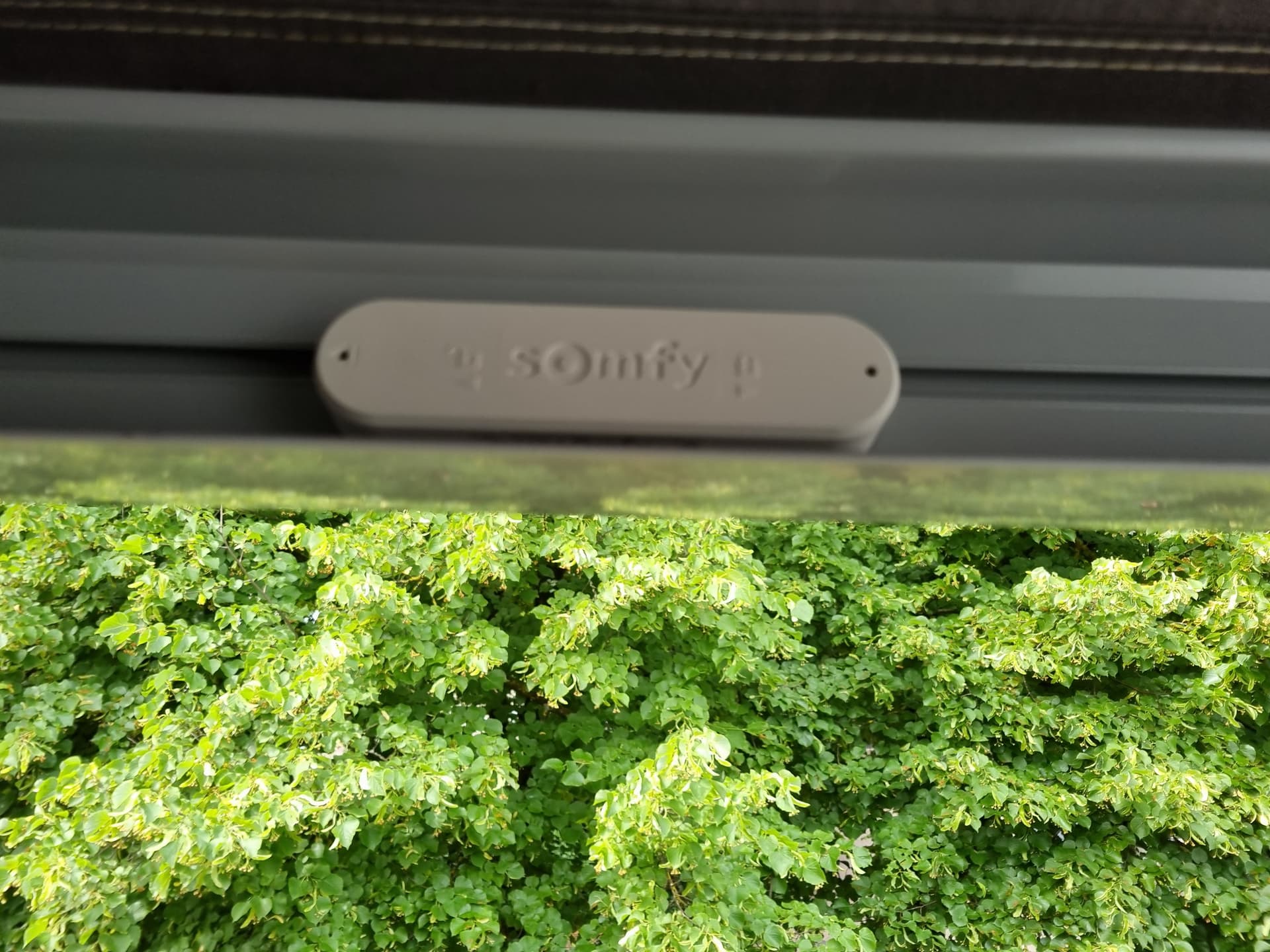

I like your app very much, but i have a request if it’s possible. I have the somfy eolis 3D wireless IO placed on my sunshade. This sensor picks up movement of my sunshade if the windgust is increasing and too high and thereby closing this sunshade. But i would love to connect it to my homey as well that when it is triggered by the sensor to close the sunshade a flow is triggered to pull down my blinds.
Is this possible?
If you can send me the Device log from the app settings page and if possible the Information log just after the sensor has closed the shade.
From what I have seen in the past that type of sensor is not directly exposed but the shade might report the reason for closing when it happens. I’m not near my PC at the moment but it’s something like the derogation status.
Thank you @Adrian_Rockall .
Your the greatest. Just sended you the device log.
As I expected, there is no sign of the wind device in the Device Log.
I have looked through the code and for some blinds (‘ogp:awning’) there is a handler for io:PriorityLockOriginatorState, but yours is a ‘io:HorizontalAwningIOComponent’. However, that state is only sent when the condition is active, so your might be the same.
So the trick will be to send the Information log when the condition occurs. One user with Velux windows managed to simulate rain by sprinkling with a hose and managed to capture the event that way. Not sure if it’s possible for you simulate wind by blowing on the sensor in some way.

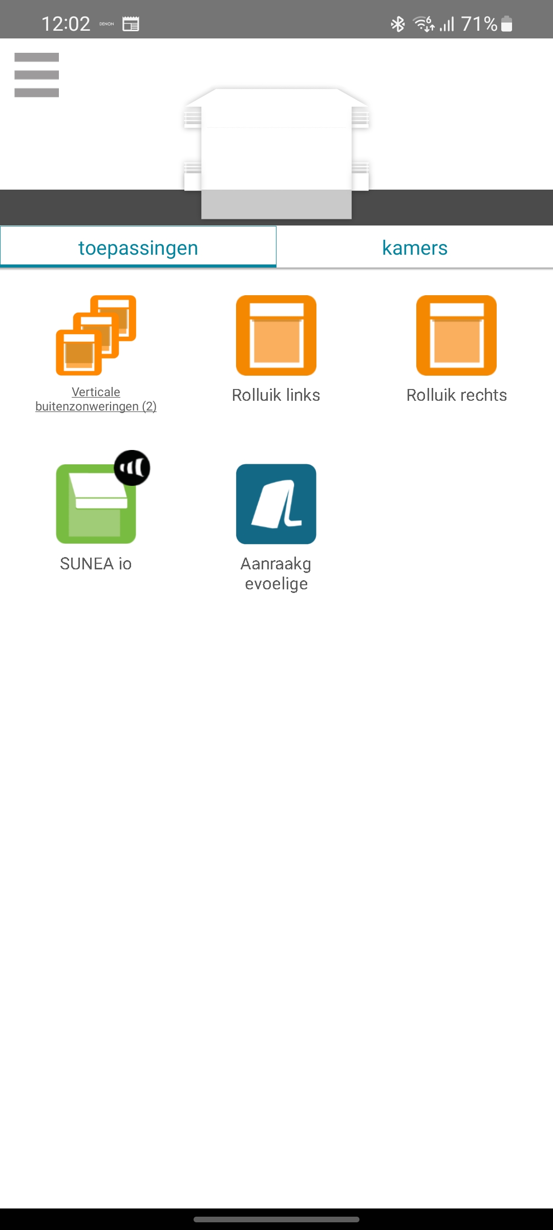

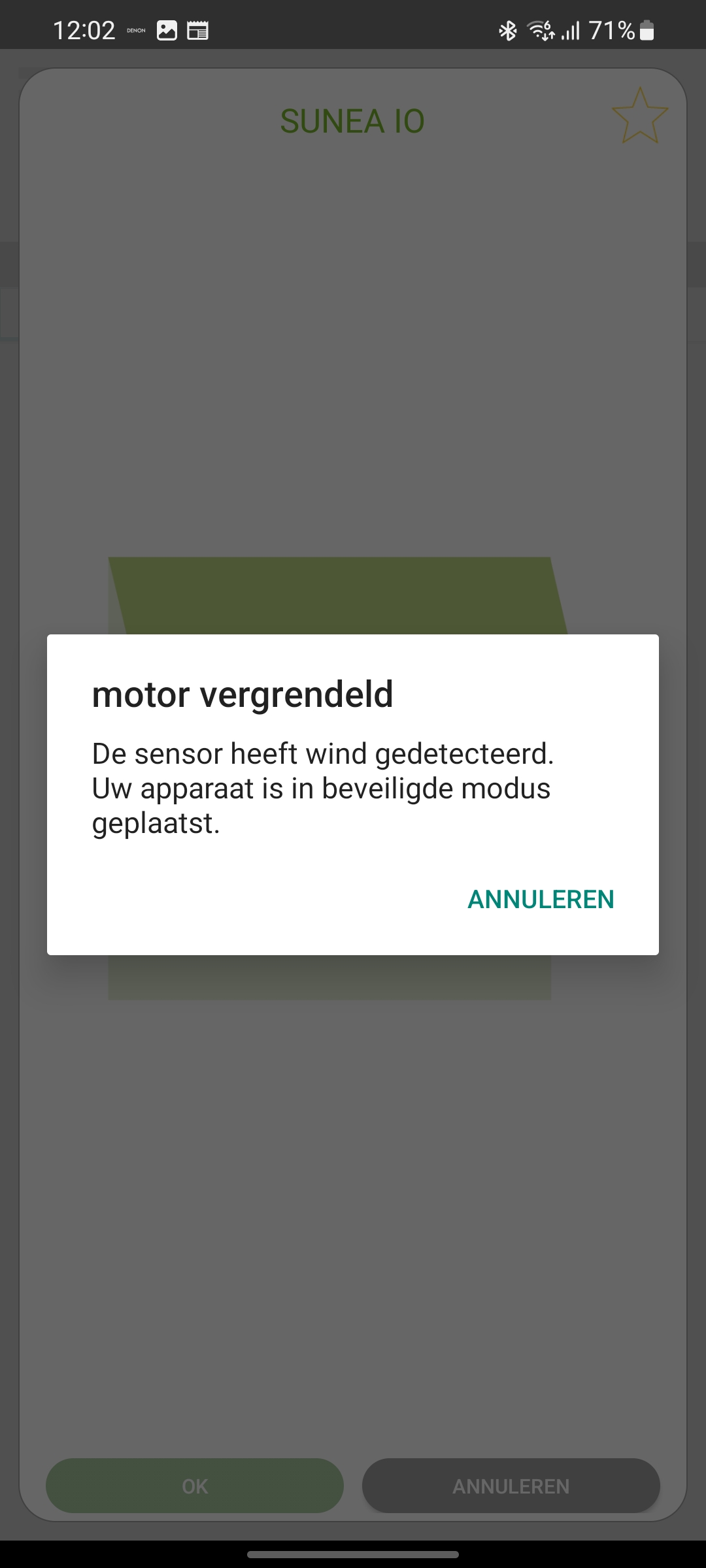

You are quick. It is triggered by motion of the sunshade. Not by wind itself. So i shook the sunshade untill it retract the sunshade. But if you don’t see it in the logging it is detached on the io-motor. Not on the somfy connecion. But it blocks the sunshade by app for a around 10 minutes and can only be controlled by remote. Can you see that trigger. I think the hub somehow knows what is done.
Did you send the Information log just after it retracted?
Yes i did. And waited untill it is completely closed. It was closed by the sensor after a few seconds of shaking the sunshade.
Strange, I haven’t received it.
Even better would be if you enable the Event Log in the app settings - event log tab, then simulate the condition again and then try sending that log.
The log will be much smaller as it only captures events and not all the other noise in this case.
I will try that. In the mean time i hope this pictures helps.
Sended. And thanks for looking into that.
