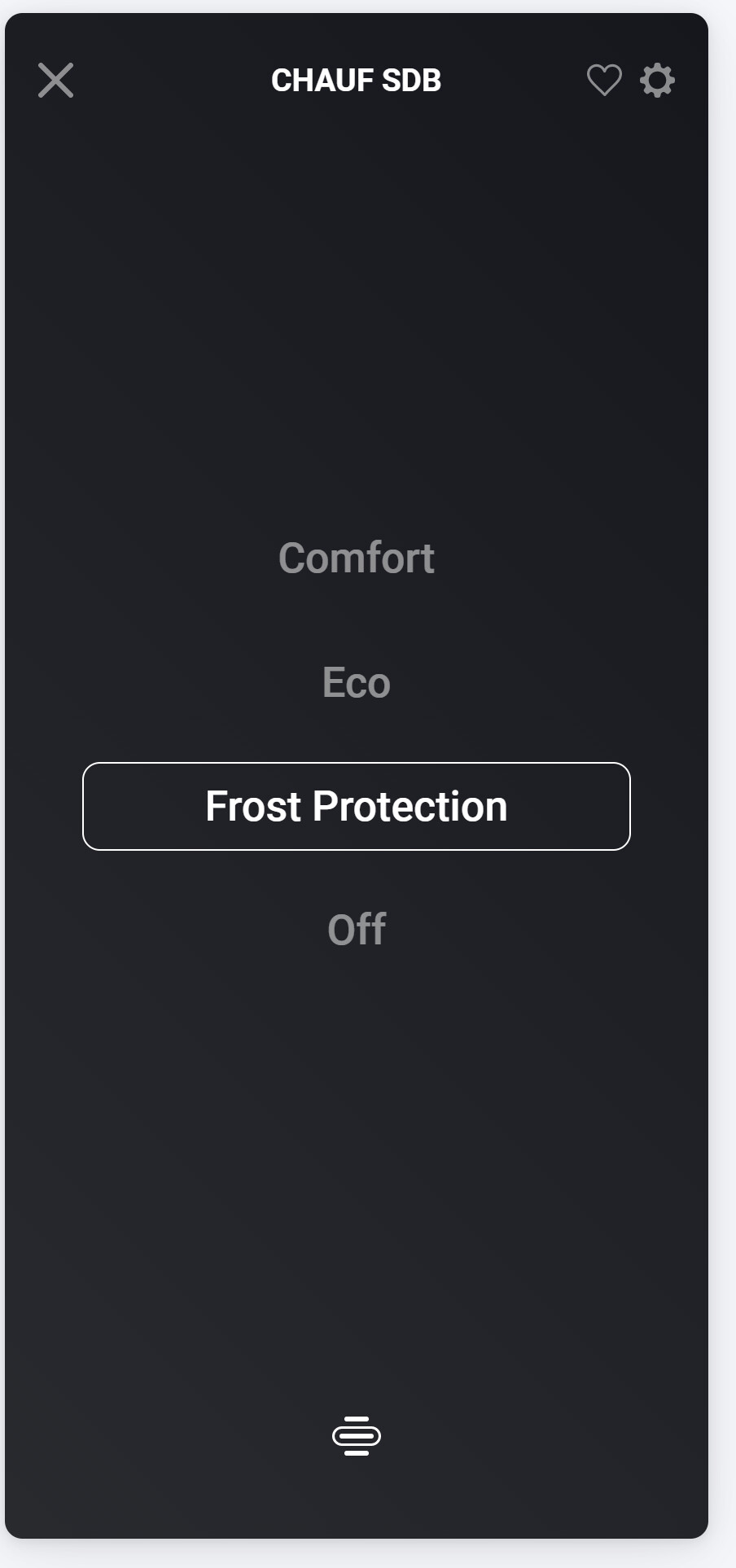

I have cheked and install test version and device again. But I still cannot see action card on the I/O heating wire pilot controler.
Ok, I will check that one.

Thank you for your effort unfortunatly no changes. New versions was installed on my Homey, I have restart it and reinstalled the device but still no cards. Only possible to control them in manual but not in a flow. You could find in attached some screenshot.
