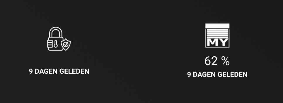

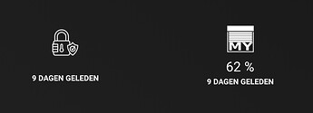

The status of the screen don’t seem to be updated in this tab. In the other tabs (i.e. the slider for up down) it is… has this to to with the local access not working properly atm, because of the same difficulties Somfy is experiencing?
Does your screen have the Set state card?
If so then I think you can use that to set the state to Idle to stop the current action.
