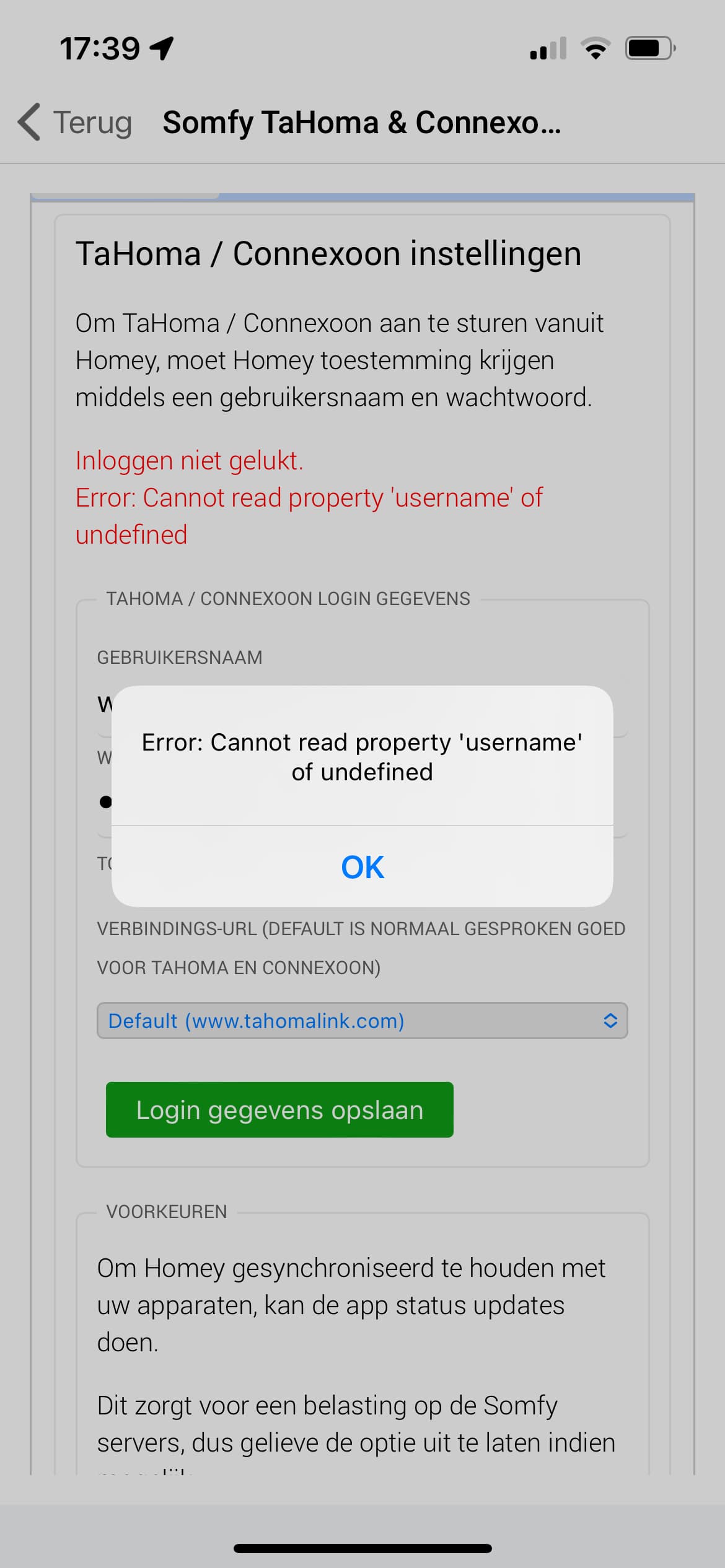

After the update from 35 minute’s ago i am logged out and can’t login again?
Could you try logging in via the repair option on one of the Somfy devices.
Open the device tile > tap on the cog in the top right corner > tap on Maintenance > tap on Try to repair. then login via that screen.
I will also check why the Config screen has stopped working.
Repair did not work, i went back to version 2.1.77 and it is working again….

Hi Adrian!
Two days ago Homey updated the app to version 3.0.2 automatically. After this none of my 19 IO-devices was responding. I restarted the app manually - and everything worked great again!
Yesterday my blinds wasn’t responding - I restarted the app again and everything worked again.
Earlier today my blinds wasn’t responding again - I restarted the app again and everything worked again.
Now it isn’t responding again.
I have just sent you a information log where I try to control one blind, try to repair without success (error 400), then save credentials under Configuration, Settings tab. After that login was successful and the blinds reacts again… :thinking:
Thanks for the information. I will look into it to find the problem.
I have hopefully found the issue and published a new test version.
I have tested with 3.0.4 and the problem seems to be gone.
I’m keeping an eye on it for the next few days.
Impressively fast solved! Thnx! :bowing_man:t3:
