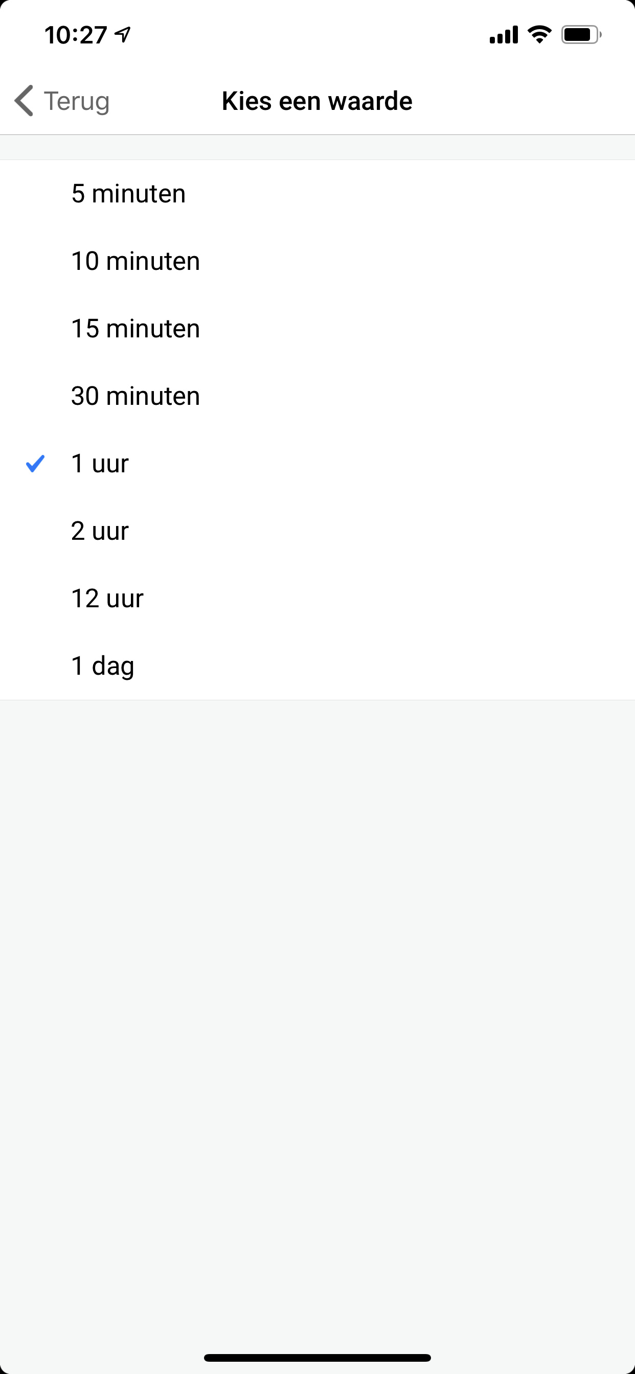

As I posted above. I’ve 6 flows for reporting. They all are turned off by Homey due too many reports, within a day or two.
See pictures above here.
Screenshot from my settings is 1 hour.
I’ve options from 5 minutes - 24 hours.
So 1 hour is reasonable right?

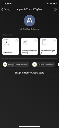

After a restart the aqara app doesn’t want to start. I dont want to uninstall the app since i have too many devices to re-add. Any idea what this could be?
I tried a homey restart as well as an app restart
9ce3a52e-8e18-4192-80d4-b880ddf999f6
Diagnostics
Zigbee initialization can take up to 20 (and sometimes even more) minutes after restart. Many reports of that lately. You can try to do a PtP (power disconnect for about 15 minutes) instead of a warm restart.
