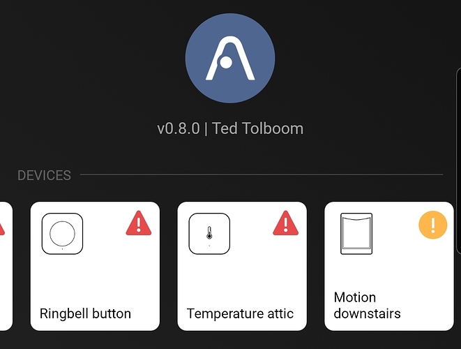

Hi, some sensors are not reachable randomly after my regular reboot at night, app restart don’t fix it. I have to reboot whole Homey to get it fixed. What is odd, it’s happening like in 1 out if 7 regular Homey reboots.
My setup could be specific however, as I’m using several Ikea ZigBee routers to get aprox. 30 devices working. Yet maybe it’s worth to share.
Not sure if it’s something to be addressed to you @TedTolboom or to Athom support? (yet this happens with Aqara / Xiaomi devices only and not for example with Ikea ZigBee repeaters or ZigBee power outlets) . Also I’m not sure if always the same devices are unreachable (I would need to observe this first).
Also I’m not sure but I think I observed this first with 4.1rc2 version of Homey like 3 weeks ago.
Before restart : 84c41a82-4e29-4610-93e4-4f0b683add9b
After restart : 9a939f3a-b57b-4c0b-966d-2cfc780382aa

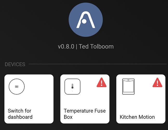

All my Xiaomi devices are not available. Buttons are showing as above with the red triangle with exclamation mark.
Sensors seems to be working tough, as my other devices are responding to the signals as they should (light on, report the door is open).

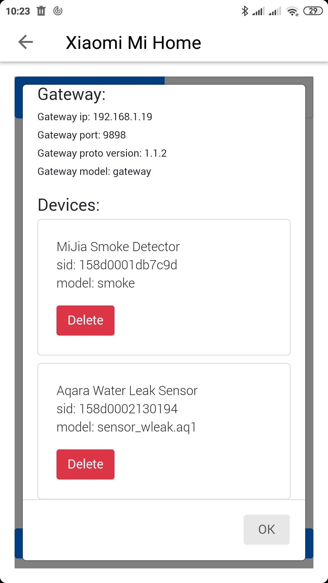

When I was using Maxmudjon unofficial app, it supported water and smoke sensor via xiaomi gateway. Since he overtook the appstore app here the two sensors are not possible to add as a new device, however I can see them hooked up to xiaomi gateway.
So i am sure it does not relate to Zigbee reweite when you have Xiaomi gateway but only for direct connection of the sensors to Homey. Unfortunately these devices were not implemented here yet.
