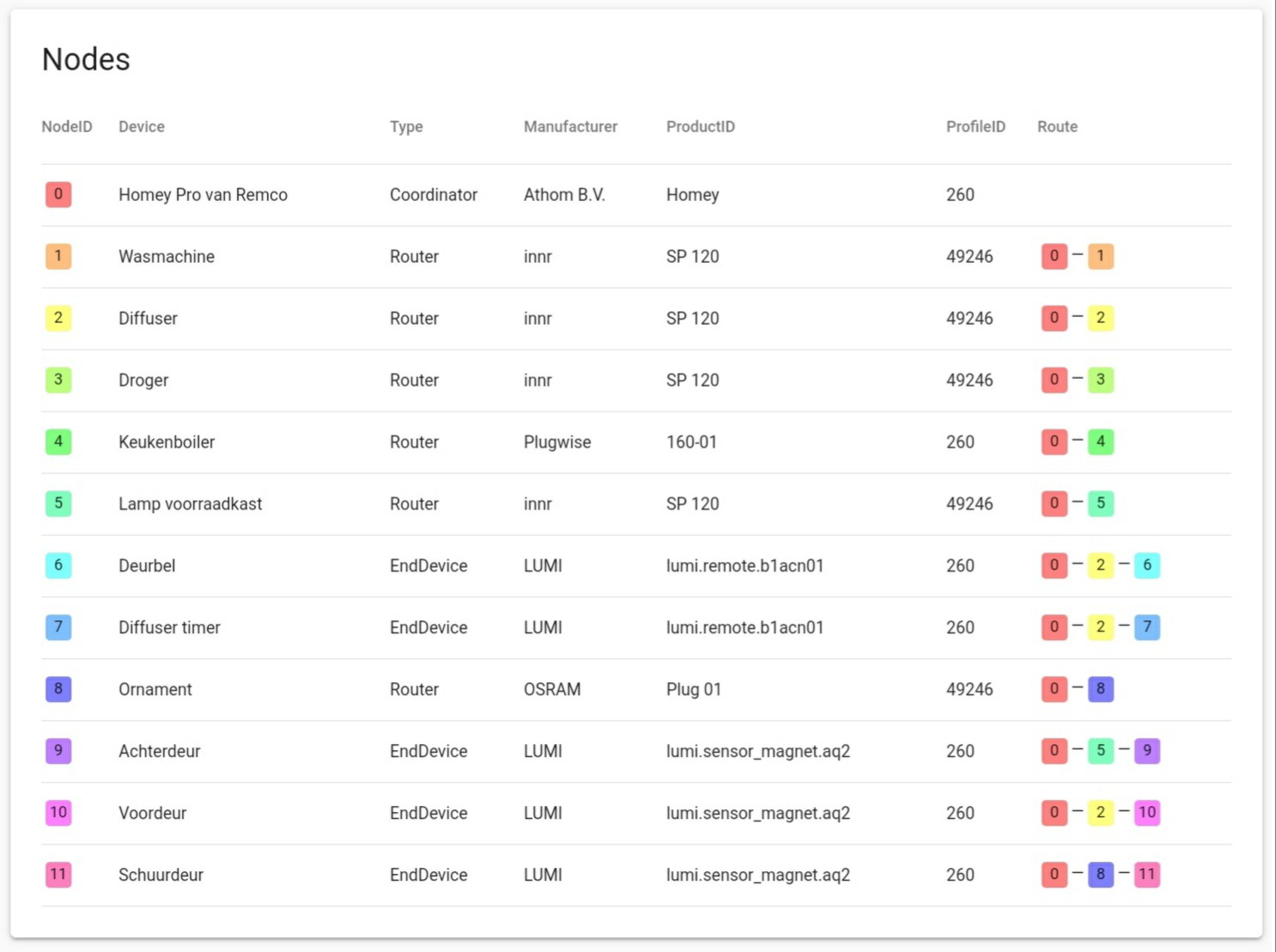

The aluminium foil seems indeed to do the trick :slight_smile: I tried it with aqara door sensor which was directly connected to homey. After removing and adding the aqara door sensor with aluminium foil between the enddevice and homey it connected to the nearest router (Innr sp120) instead of directly to homey to prevent the 20 connection limit. It can be seen back in the route section of https://developer.athom.com/tools/zigbee :smile: so big Thx.
Btw, Do I have to remove and add devices or is there another way to reconnect devices without breaking flows.
You might be able to get it working by removing the batteries from the device you wish to “move” to another router, then set up the aluminium foil, then put the battery back in and hopefully the device reconnects to the mesh through a different router.
Thx for the tip. Removing a battery from an enddevice like an aqara door sensor or aqara mini switch, set up the aluminium foil and then replace the batteries back seemed to work fine, without breaking flows.
Cool this way I’m able to connect enddevices easier to routers instead of directly to homey (to prevent reaching the limit of 20 zigbee devices that can be connected directly to homey).
Edit: added image of homey zigbee route:
To answer your first question: yes. Usually a battery powered device is a client/endpoint. While a non-battery (mains, i.e with a plug) powered device is usually a router. A router can amplify/pass signal for other clients.
Homey can handle a maximum of 20 DIRECTLY connected devices. But it can be more, if those devices, like in your setup connect to Homey via router devices.
