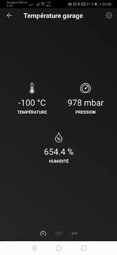

Don’t have the -100 but my sensors haven’t reported in for at least 5 hours. Now rebooting my device because in the developer site all zigbee node ID’s are “-1”. Doesn’t seem right. I updated to RC8 5 hours ago.
Edit: Works after the reboot, all zigbee nodeID’s are back again.

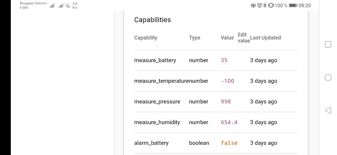

Well, the last updated status seems a bit off, right? 3 days ago? I would not think there isn’t a change in any of the sensors in the past three days.
Try pressing the little button a couple of times to see if it updates again. And what does it look like after the ‘map’ has been generated in the zigbee overview.

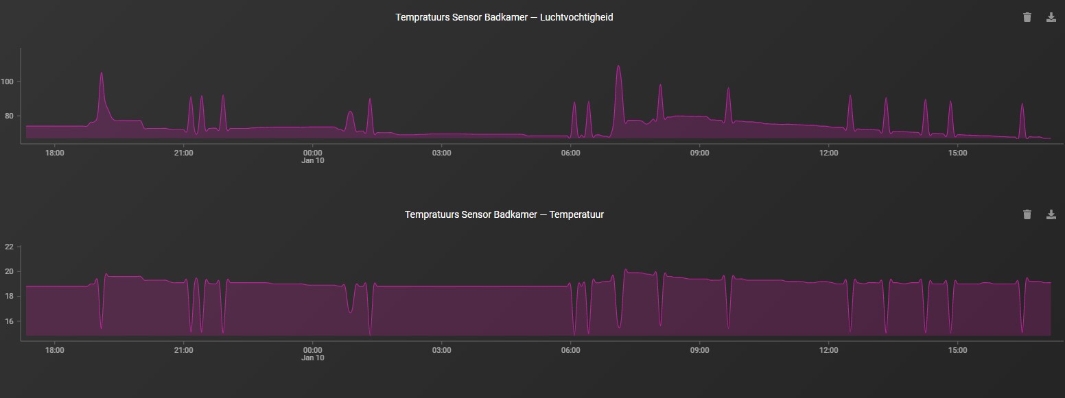

Sorry if already discussed (quite a large thread this is :))… what I noticed since a month or 4 now is that insights, specifically for the aqara temperature sensors, shows strange behavior in its graphs. Every sensor suffers from this (I have about 7) where the graph shows dips every X minutes to extreme temperatures, messing up the ability to properly read the timeline. I know for a fact that this has been working perfectly fine in the past but now it has been acting up for quite a while;
When this occurred recently (check in insights), can you or @Martijn_Hoogenbosch me a diagnostics report? Please indicate the -100 in the comments.
Appears to be occurring more on devices further apart from my homey so it might be reconnects causing this (not based on deep analysis of course, just a hunch.
Last occurrence was today at 11:54.00 for the Attic temperature sensor. Uploaded report.

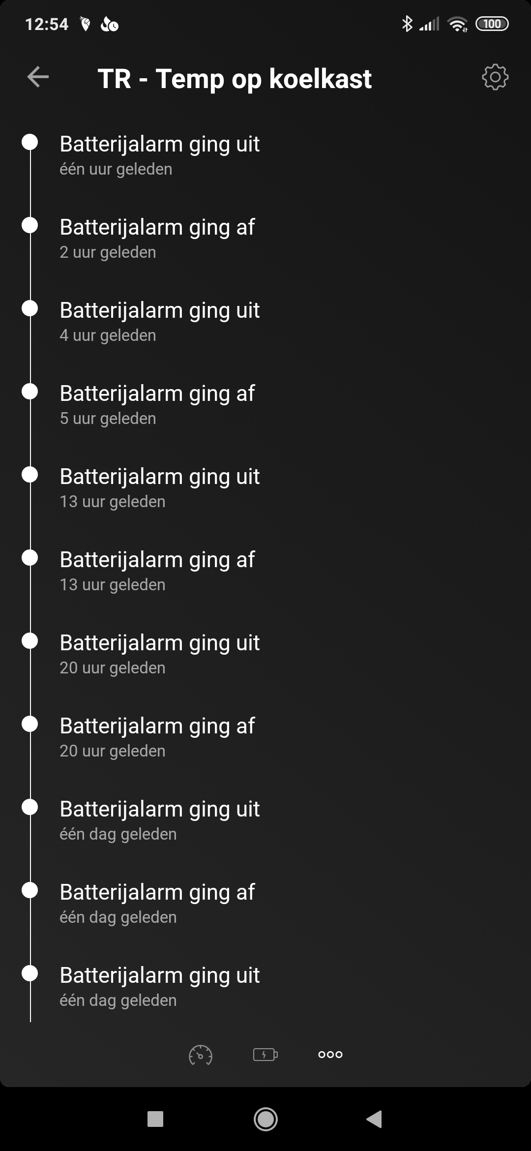

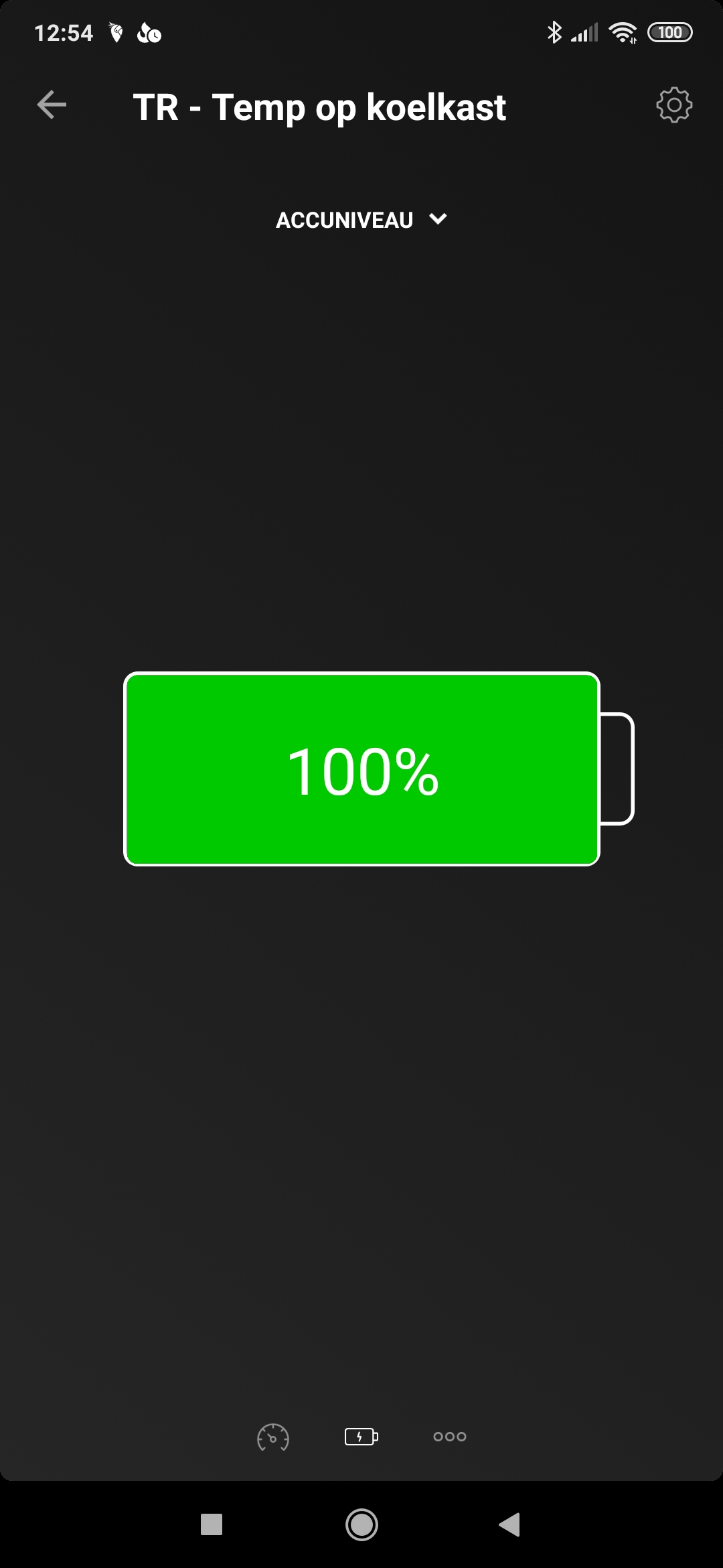

As we are reporting odd behaviour… I too have a strange issue. I have several Aqara temp / huminity sensors. These have all been working fine over the last year.
One of shows strange battery alarm:
The device responds to changes in the setting, reports temperature /humidity as should and has a full battery. What could be the reason of this od behaviour? A loose battery contact?
